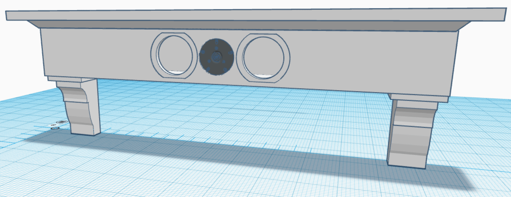

I came up with an enclosure volume of 12.8 litres and then modelled this enclosure design on TinkerCad:

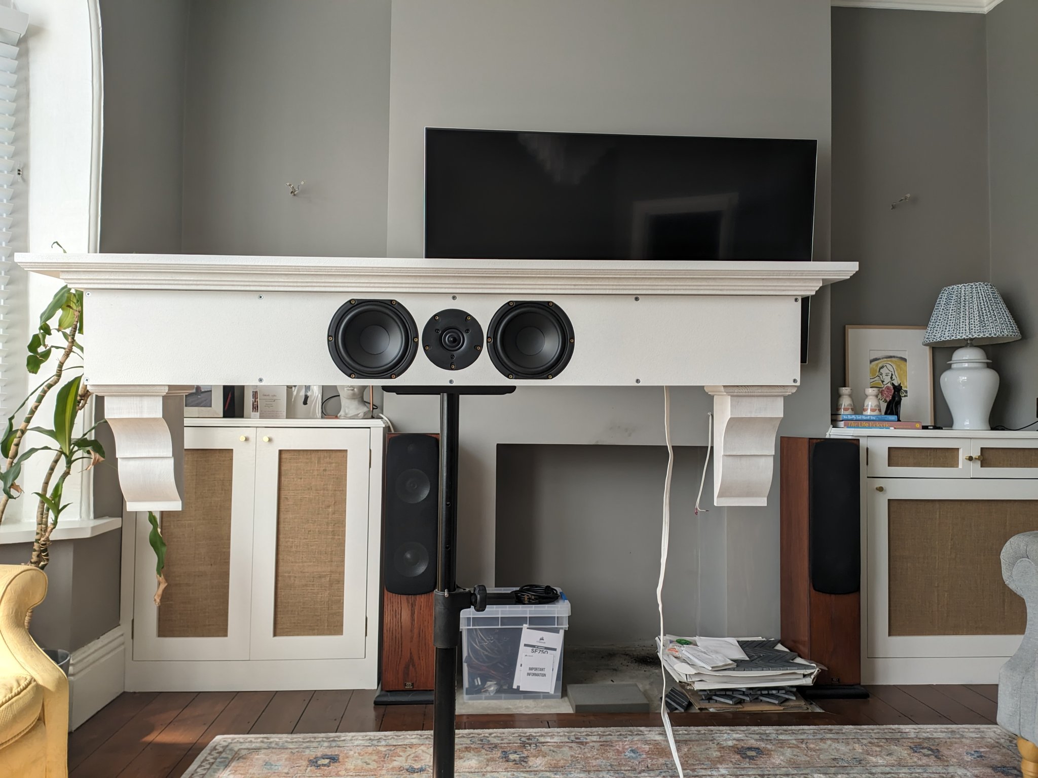

I built the unit and took measurements with a boom arm and Umik-1 following the guide at AudioScienceReview here and came up with some reasonable looking graphs which follow the manufacturers anechoic graphs close enough to look legit to my untrained eye.

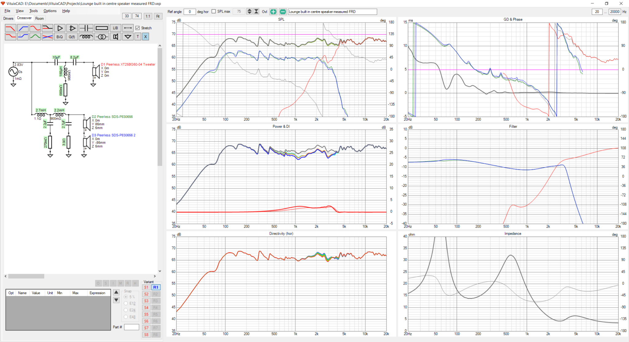

Now comes the tricky part. I seem to have a ~3khz dip in the tweeter response and I'm trying to design the crossover on VirtuixCAD2 and would like some help.
I measured each of the 3 drivers with the Dayton Audio DATS v3 to get accurate t/s specs and then input that data into the software. I think I've got it fairly flat (as best I can) but I'm not sure if the phase response is going to cause issues or if the resistance is too low (going down to about 3.1 ohms).
I'd love some feedback to assist with the crossover design as I want this speaker to sound great!

A few observations/questions:
1) Your 2 midbasses can be put in parallel and driven off one crossover leg. That will cut your crossover complexity down significantly.
2) Are you asking how to fix the dip at 3 kHz in the tweeter response with the crossover? If so, that's not the way things would typically be done. The dip may be an artifact from the geometry around the tweeter (the molding above being a likely culprit, or the step below). This is likely to change with vertical angle and when you place the mantle against the wall. I can give more suggestions on how to try to figure out what's going on, but they may not be relevant when you get it against the wall (or a temporary test baffle that approximates a wall if you'd rather do that).
3) Have you measured the tweeter and midranges together and tried to get Z offset correct or done something else to handle that in the simulation? If you haven't, your phase information isn't likely to be correct. I can explain this further, but it's kind of involved and don't want to waste the space if you already know it.
4) Given the sensitivity of the tweeter and midbasses, the padding you have on the midbasses seems suspect (the 2.7 ohms).

Thanks for the feedback.
I've put the tweeter at 0mm of z Offset as it's flush with the baffle (unless I need to account for the dust cap?) and I've put the woofers as 10mm z Offset due to the flush mount but cone being concave.
I didn't think I should take measurements with the baffle/enclosure mounted to the wall due to the reflections I'd be measuring and not the speakers performance. I expect my avr will correct the reflections etc to the best of it's ability.
I've made a new crossover design based on the feedback.
How does this look? Anything else I should do?

I followed the audiosciencereview.com guide on taking gated measurements but it's my first time so maybe I did something wrong?
I setup my umik-1 on a boom stand and set my speaker cabinet up on an adjustable hieght pa speaker stand in the middle of my lounge (4m x 3.5m x 2.85m with a round bay window on one side). I did several measurements and found the best height for the speaker and the best distance for the microphone.
I did consider doing a 2.5 way design but thought for simplicity I would do a 2 way design to begin with.
I'm aware that a horizontal MTM speaker design isn't ideal but I thought that given the relatively small driver size, the dual bass drivers would allow lower distortion.

Your woofers are in series in the new layout. They should be in parallel. The level is probably going to look wrong compared to the tweeter, but as discussed above, there's probably something going on in your measurement that's skewing things.
The acoustic center is typically close to the front of the voice coil (where it attaches to the cone in a woofer). I would expect something greater than 10 mm for how you have things laid out, but I could be wrong. This can be determined experimentally by leaving the speaker and microphone in the exact same locations, then taking a frequency response measurement of the tweeter on its own, the tweeter and woofer together, then the woofer on its own. You then load the individual driver responses into the model for each driver. Then load the combined response as a reference file. In the model you also have to have the physical setup correct for the individual drivers and the microphone. From there you can adjust the Z offset in the model until the predicted response matches the measured response for the woofer and tweeter combined.
If you don't want to get that involved in the modeling/measuring, you can also just build the crossover and tweak it on the fly. People have different approaches to things.
The higher the crossover frequency, the more critical Z offset becomes if you want an accurate model.

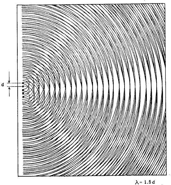

From a vertical perspective, combing for a center channel HT speaker is not an issue. Such speakers are set up, angled, to aim at your seated ears, because we sit to watch movies. We want a narrow vertical beam and a wide horizontal beam. What we're looking for is reasonably "tall" waveform devoid of perturbations by stuff above and below the drivers. In a "normal" configuration such drivers will have a flat screen right above and God Knows what below, so some means of minimizing the interference from those surfaces is important.
As your drawing above shows. such a pair launches a broader "vertical" wavefront at the listening position. Indeed, your drawing proves why such a configuration is perfect for a HT center channel speaker.
The acoustic effects of diffractions from surfaces above and below the drivers will be different, so hopefully they will "spread" out at the listening point.

Any critique on the new crossover?
I was told that I should be in series to bring the woofers down to match the tweeter and also so I lower distortion vs parallel. Does this sound correct?
That's a good write up... which emphasizes the importance of avoiding lateral lobing.
Recall that for a HT center channel we want very wide horizontal dispersion. People will sit on couches and chairs around the TV and those angles can easily be 35 degrees! Unless you have a High Falutin' HT room... It's important that people watching TV at a an angle also hear the full sound.
Going by the spec sheets, no.
The woofers are 85.7 dB sensitivity. The tweeter is 92.3 dB. As Turbowatch2 pointed out earlier, when the two woofers are put in parallel, you basically just get up to the sensitivity of the tweeter. In practice, the tweeter may still need a little attenuation to produce a more relaxed sound. Though if you like what's often called a more revealing sound, you may like the tweeter without any attenuation.
