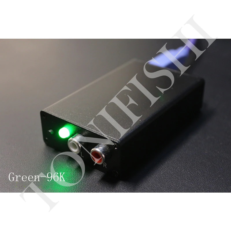

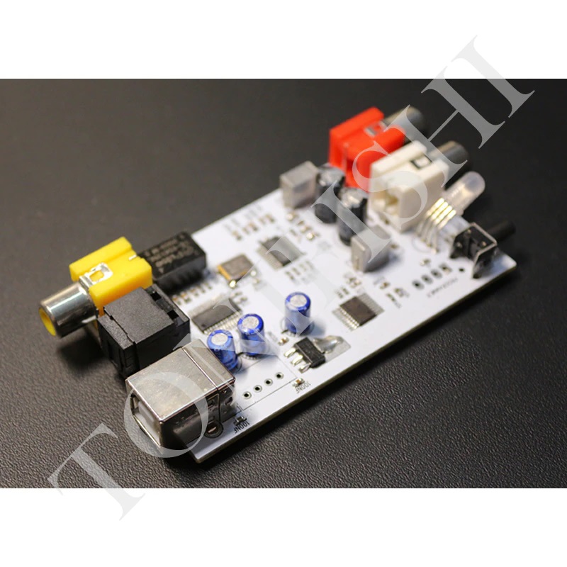

for audio input and output I plan to use these 2 devices:
*Analog to digital converter ADC (rca to usb):
Analog input: lotus seat L/R
Input level: Max. 2Vram (2V effective value) = 2.8Vpk (peak value) That is, the standard analog output of CD will not be distorted to the output of this board
Output: fiber coaxial PCM 0dBu
48K/96K/192K free conversion with high sampling rate
Signal to noise ratio -100dB

*Digital to analog converter DAC (usb to rca):
Output: 3.5mm headphone jack, RCA
Bit depth: 16bit /24bit
PCM USB Input decoding rate :32bit/384kHz
Sampling Rate Support:
PCM: 44.1kHz, 48kHz, 88.2kHz, 96kHz, 176.4kHz, 192kHz, 352.8kHz, 384kHz
DSD: DSD64, DSD128, DSD256 (2.822, 3.072, 5.644, 6.144, 11.2896 and 12.288MHz)
RCA Output level: 2.5 Vrms @ 0dBFS
Frequency Response: 20-20K Hz +/- 0.15dB
Low distortion <0.005% (20-20K)

Jitter can be as low as 4.6ps. Support 32B 384khz asynchronous transmission
