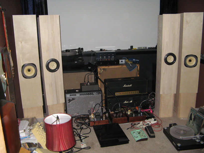

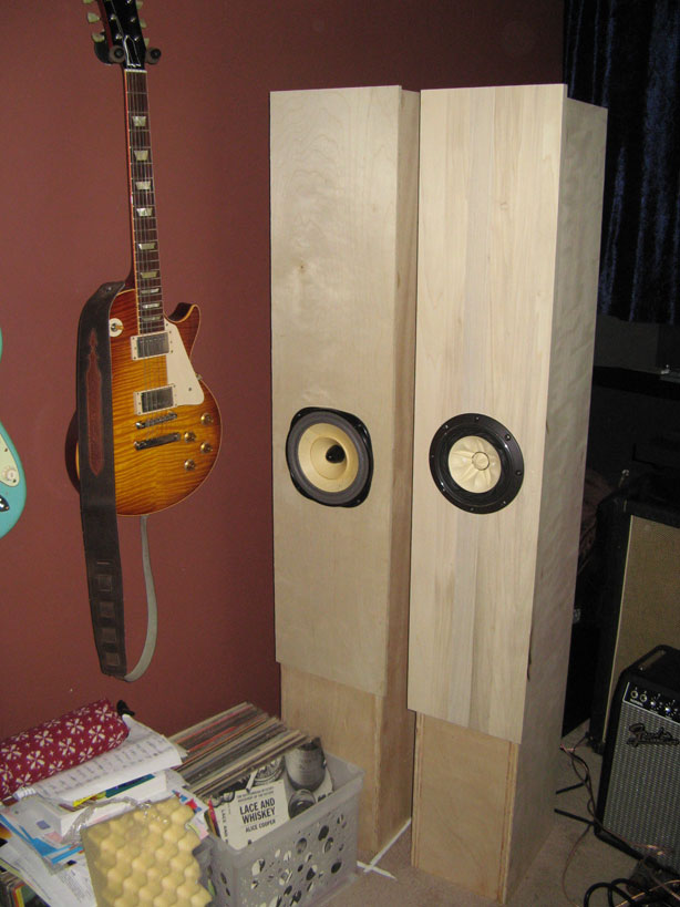

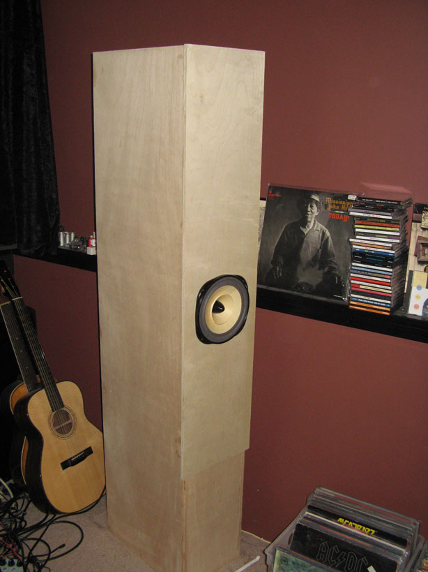

Wow, all I can say is that the Lowther Drivers are worth every penny. They only have an hour of play time on them and they're clearly better than the Fostex 168 sigmas that I built a few weeks ago. The presentation is more full, clear, crisp, and lifelike. Sounds like a curtain was in front of the Fostex drivers.
Here are a few pics. Excuse my mess but I'm revamping my entire system and need to get rid of stuff. As it is I'm doubled up on amps and speakers. Now that I've got the SET/horn bug, the traditional stuff will have to go. Thanks again to Zilla for his BIB site and Scottmoose for the dimensions. Up next is the Sachiko. I can't wait to hear what the Lowthers will be like in that enclosure. 🙂

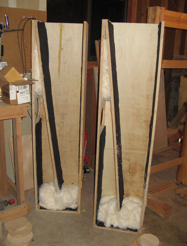

Here's a pic of the insides. I messed around a lot with my Fostex BIB until I got it to sound right so I did the same to these before I glued it shut. I just stapled the wool blanket in place so it's prety easy to remove.
I also used this new stuff I found at the fabric store called bamboo fiber filler. Don't laugh, but when I shouted into the bag it seemed to damp the sound much better than the regular polyfil. It's super soft and fluffy.
