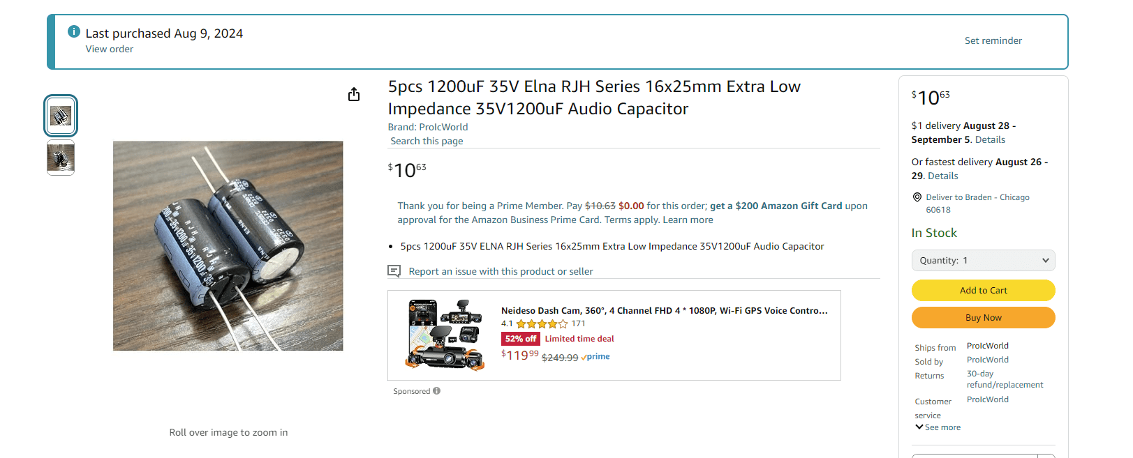

Just to clarify, that is a 1.2k uF cap, 1.2mF, or 1200uF. Remember that has to be nonpolar electrolytic, or a pair of polarized 2400uF back to back in series, or a VERY large poly like these:
I ordered these guys here. Did a bit of research and found out Elna is a great brand. 35V only so IDK. I didn't realize voltage would just that high. Usually audio stuff stay pretty low. If it did jump to 200V it might arc across my terminals.

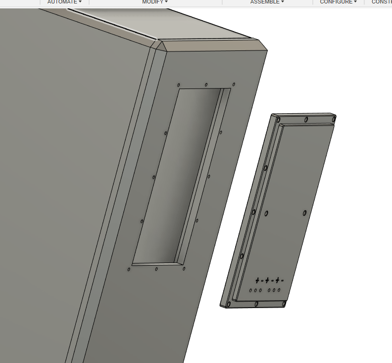

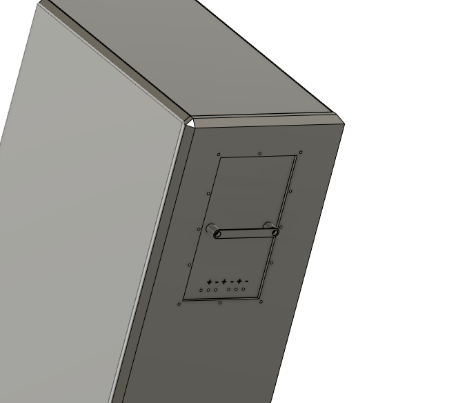

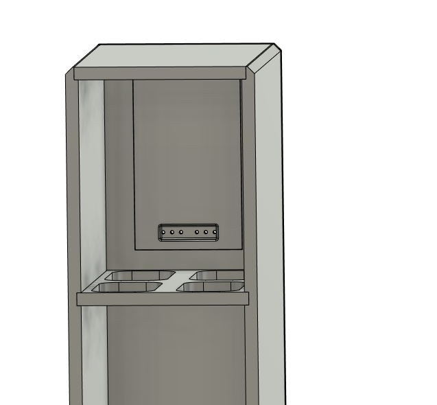

My XO is removeable. I just unscrew it from the back and it pops out sort of. It has a sealing gasket. I'll show a pic of the cad. It seal from the inside so the bass pressure actually forces it into the gasket rather than trying to push it out of the cabinet. See that the inside is large than the outside.

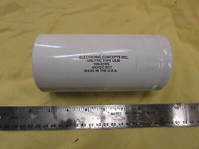

Hmmmm.... So they have to be non polar, non inductive, 1200uf, and take over 100V?
Going to be harder to find than I thought....
I did find some on digikey but they were 20% tolerance which I considered to be too high of variance for the application.
