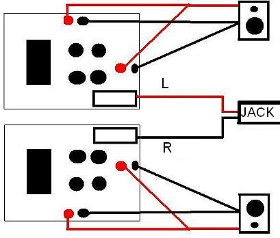

hi. i'm new of this world. i don't have more practice whit mod, and i've some question.
I'm making the first mod that i saw on the michael mardis's site, and now i wanna "link" 2 t-amp to have more power whit only 2 speaker.
it's right my project (see attachment)? I wanna use just 1 pot, what tipe i've to take?
i have to change other componets for make my project?

Hey MEXX Looks good! Very clean layout, nice box. Looks like a guitar amp. =) Are you doing a LCRS, or just biamping stereo?
Norbertom: You can't do it like that. Don't hook the 2 channels together, the T-Amp is not set up that way.
All you "might" gain is a little extra current, but not much. You won't get enough extra power to be worth it. And you would be getting into a world of trouble connecting the 2 channels together like that.
If you wanted to do something like this, but run the tweeter and woofer sections seperately, that would be OK. It looks like that is what MEXX is planning.

bi-wiring, right? i need to mount a croosover on the t-amp or i need only to add 2 more cable at my speaker?
ok. for the volume pot i need a 100k? the 50k is the same?
The speaker needs to be set up for bi-wiring, i.e. the tweeter needs to be able to be decoupled from the midrange.
Even then, you don't get the full benefit of bi-wiring without bypassing the crossover entirely and using an active crossover before the amps.
Just looking for more power? Use a different amp.
