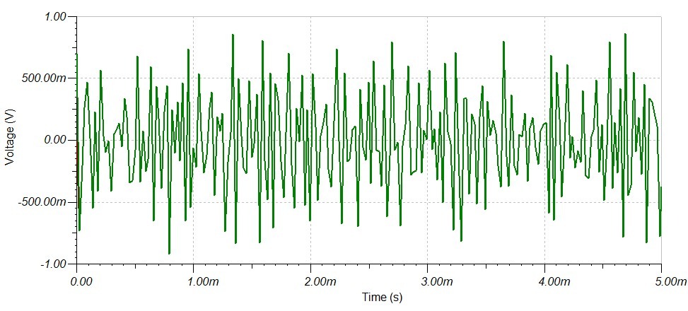

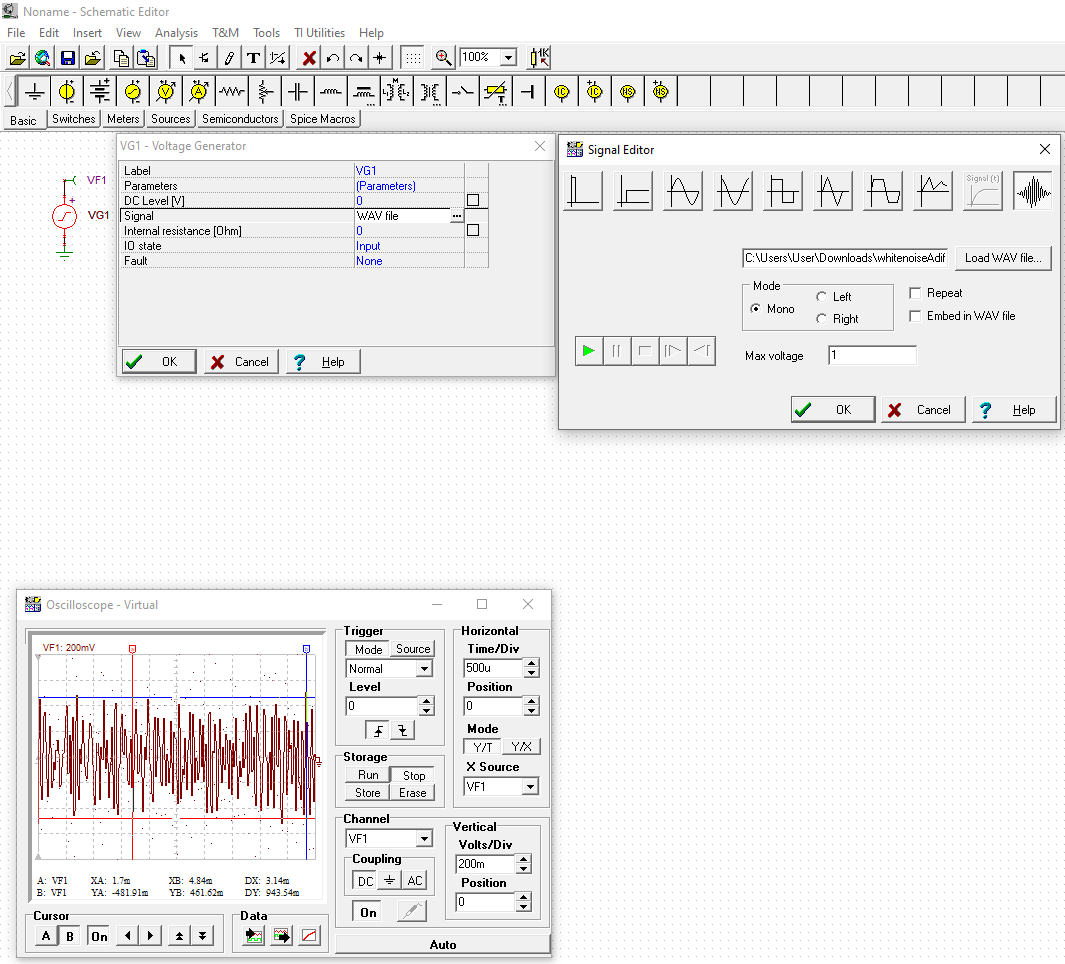

Here is a basic short transient analysis of this Noise sample I downloaded
Using TINA TI
Screenshot showing schematic
just a voltage generator
Double click Voltage generator to open properties.
Select .WAV click to open signal editor.
Open the WAV file.
Can use a scope or transient analysis
Using TINA TI
Open the WAV file.
That tells you what gain TINA TI applies to imported .wav files, but still doesn't tell you anything about the gain of kunal_yadav's recording chain.
