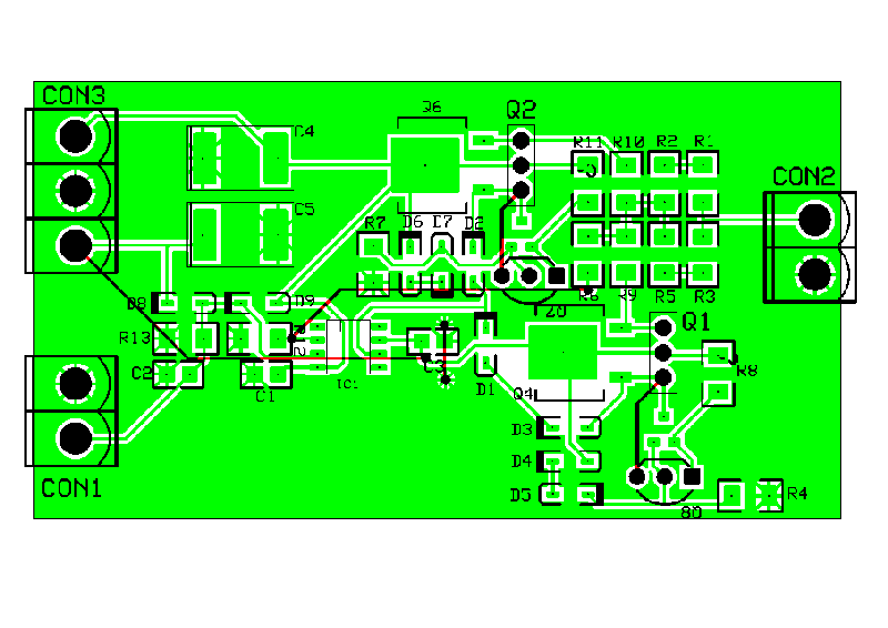

I was thinking about these parts:
- BC components MMA0204 resistors, 1/4W, MELF package (1206 compatible package)
- Tantalum and ceramic capacitors
- BAS32 diodes (I got some of these and they're supposed to be 1N4148 equivalent.)
- AD797 opamp, SOIC package
At the moment I'm considering making a layout with both SMD and through hole mount for the transistors, just in case.
Thanks for your help 🙂

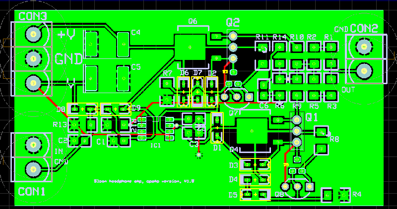

Sure. I've finished the layout and it might be sent to the boardhouse tomorrow.
The boardlayout is for:
- 1206 resistors
- Tantalum and 0805 ceramic caps
- MMSD4148 diodes
- MMBT5401/MMBT5551 or 2N5401/2N5551 transistors
- MJD340/MJD350 or 2SD669/2SB649 transistors
If you are going to use the AD797 OpAmp -- you should take a careful look at Analog's website --
http://www.analog.com/UploadedFiles/Data_Sheets/507345751AD797_d.pdf
there are some tricks to using the AD797 which they discuss -- see figures 34 and 35 in the datasheet. basically they involve bypassing the feedback resistor to keep the noise in the nanovolt region. it's a matter of picofarads ! I bring this up because it was part of the Super-Regulator thread (the Jung superregs used the AD797, AD825 etc.) there is also a distortion cancellation mechanism -- see figure 41.
also -- Q3 and Q4 (referring to the part numbers in "The Audiophile's Project Sourcebook) operate in Class A -- I don't know whether the somewhat lower-rated OnSemi devices are going to do -- when you first brought the topic up I thought you were using the devices in the VA stage. Not to worry, however, there are many DPAK devices which will handle the current.

I didn't read the AD797 datasheet initially, since I thought Sloan had considered it. Anyway, I've read through it, but there's plenty I don't understand.
I'll do these modifications:
- add cap between AD797 pin 8 and ground
- add resistor and cap in series in parallel with R5 (Sloan's schematic)
I don't know what values I'll use for the new components, so I might need help with that later. 🙂

looking at the schematic, one thing which puzzles me -- why in fact use such a high-performance opamp and then couple the non-inverting inputs to the power supply rails via the protection diodes D1 and D2. If these diodes aren't matched then you will have an offset problem with the amplifier -- and the problem is exacerbated with temperature -- further, any noise on the supply rails is fed directly into the non-inverting input.
just my 2-pfennigs worth. i hope it's not getting overly complex.
