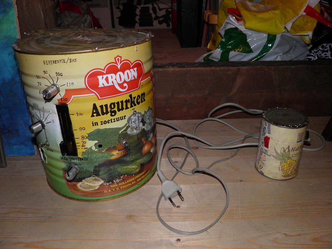

It's not difficult to build an MM preamp that works well on a piece of perfboard, as long as you put the perfboard in a shielded box and put the mains transformer at a large distance from it. As soon as the mains transformer and the MM preamp have to share an enclosure, it will take some effort to get rid of hum.

Because a while back I designed a MM preamp, along with a Sallen-Key filter for rumble, and an additional booster preamp, all in a 3x4x6 inch aluminum box - WITH the power transformer INSIDE, literally inches away from the PC boards.
And guess what?
NO hum!..... none!.....dead silence!
If "I" can do it, then it's possible to do.
So with that stated, all those 2-piece types of equipment like preamp/PS and such are more about Snake Oil than reality.
But I guess that the current "rage" about seperating power supplies and the products that are powered from them are designed to entice the public into believing such nonsense.
I never claimed it is impossible, just that it's more difficult than with the mains transformer at some distance from the amplifier.
Asides from working in a small enclosure, it wasn't that difficult for me.
It actually was fun.
Power transformers suitable for small preamps are quite tiny and any radiated magnetic fields they may produce are just as tiny.
That's not my experience. I built two moving-magnet amplifiers with the transformer in the same enclosure as the amplifier and in both cases it took some effort to get the hum level below the noise floor. I never had any issues with hum when using an AC wall wart. Maybe you used a better power transformer than I did.
In fact in one of the two cases, I resorted to using a separate enclosure for the transformer after all.
https://www.diyaudio.com/forums/att...d1612944584-finding-phono-preamp-augurken-jpg
Well, there's your problem right there.
Using such crude items as soup cans is not a proper nor reliable way to built things.
