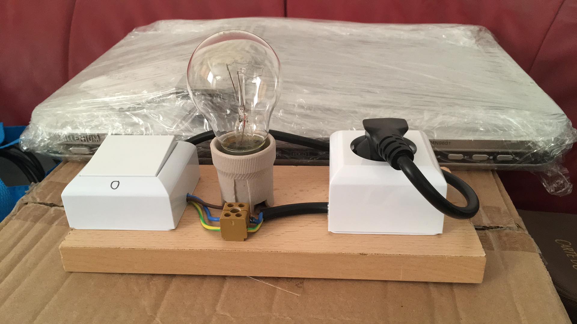

I can't wait to start these up, but this bring up questions. Wouldn't make any irreversible problems, if I give it a try? Should I connect a current limiter to them?
And also, I read somewhere that these adapters for the preamp is mandatory, if I want to connect anything to them ...
A 60w bulb in series doesn't hurt for the first time. Try and grab the voltages to ground for all the tube pins, and post them here. Then some tests like feeling transformers for heat, and you're good to go.

Thank you for your tips! This sounds eerie, but fun! I will try to operate it with the bulb, for the first time. My mains rated 230V. How to calculate the suitable W of the lightbulb? Is 60W enough, or 100W even better?

I made these for testing:

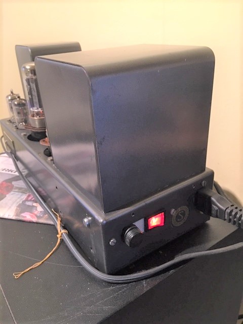

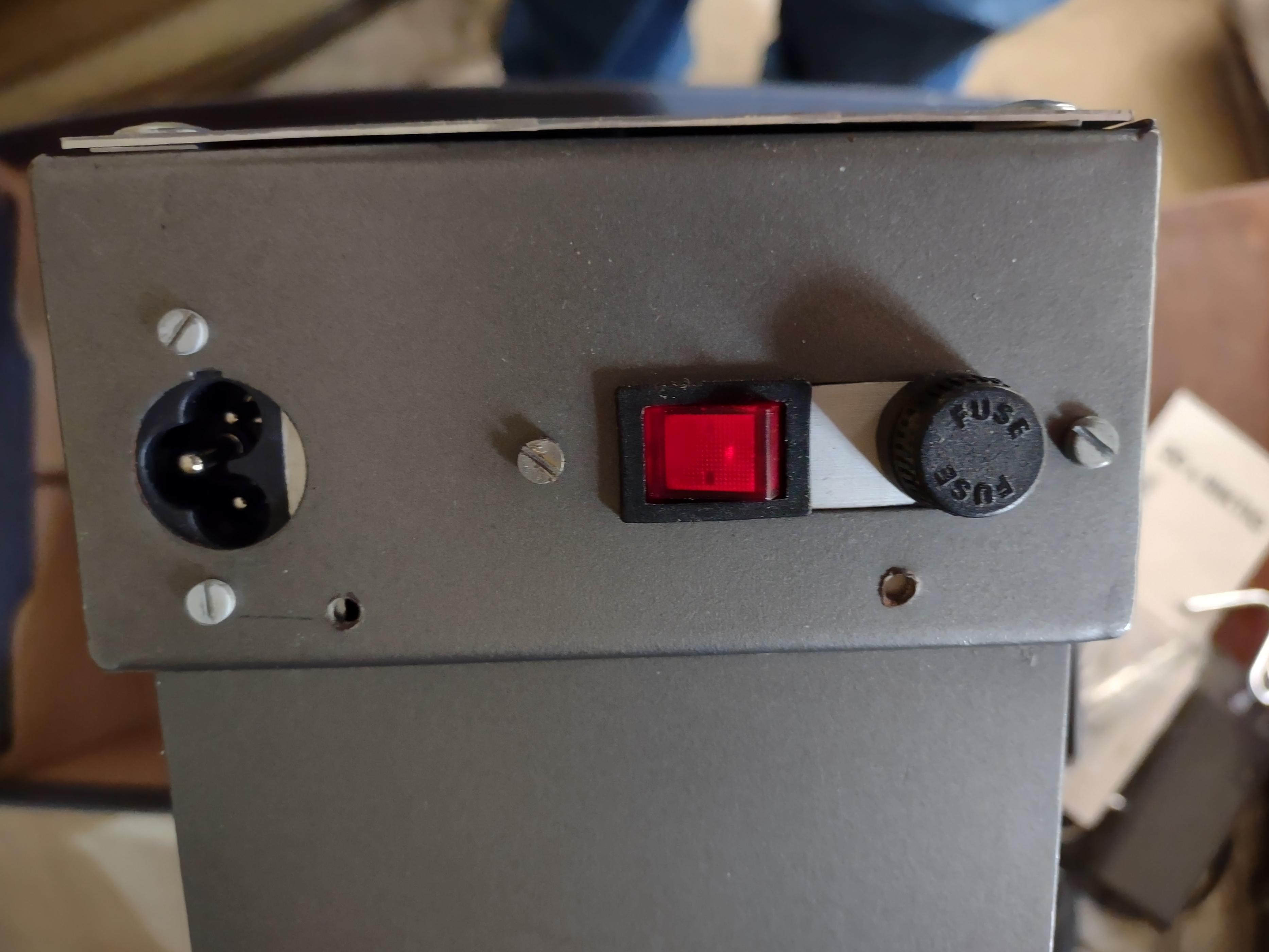

You will probably be tempted to “modernize” them when you realize the power plugs and audio input won’t really run without the 22, due to the way the ground runs through the 6 pin connector, while mains is distributed through just two-prong plugs. You will see a lot of people fitting IEC connectors and RCA inputs, but this means cutting the chassis.
There is a solution to this without surgery. I fitted a socket for an IEC C5 cable (laptop style), and it fits nicely through the fuse hole. I did drill two small screw holes for my change, but it is possible to anchor to the transformer above and the baseplate below, if you are a purist.
I removed the possibility to change voltages, and an illuminated on/off switch and fuse holder fit nicely in that space. I added a small fillet to meke the plate flush to the hole, and ensure the two items were firmly anchored.
I also drilled one more hole on the side close to the IEC adaptor for a dedicated earch connection. This seperates ground and safety earth, and the amps are completely silent.
Putting the power in by the transformer removes the need to run the mains lead from the front to the back.

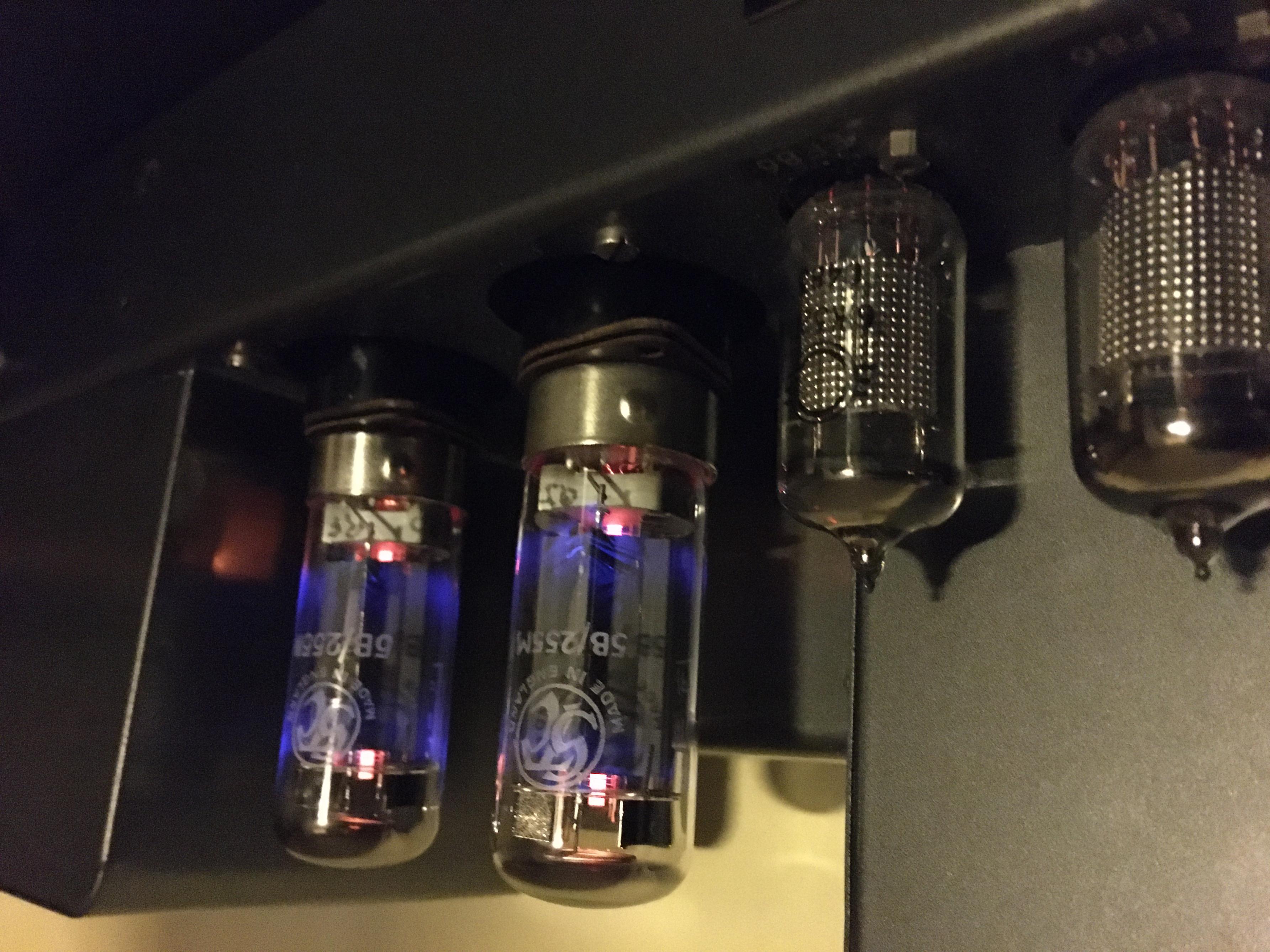

STC 5B/255M are a great substitute for the KT66, if NOS and your wallet are concerns, and I have Russian 6K32N on one of the amps, and they seem fine too!
The two unsightly holes were driled by its former owners, Sverige Radio. They had masses of them, and they converted them all to silicon rectification so they could squeeze a few more watts out of them. I bought 4 of them from an ex-Sverige Radio guy, and the other two have factory fitted cages and a rack style base so they can be hot swapped. All 4 had had all passives replaced by SR during their lives. The guy said he had around 3000 KT66 pulls from when the radio station amps were being maintained, but he was old and Corona fears put an end to our socialising.
