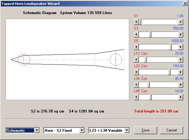

Well, I'm finally taking the plunge - gonna build me a TH based on the new Dayton 12" PA driver - the PA310-8. Specs will be similar to the ones indicated below (I'm still doing some fine-tuning). I haven't finished the folding yet, but I'm looking to fit everything into a box that's approximately 3'x2'x1' (ok, slightly wider, as the driver has to be accomodated). It's destined to be used in a small bar (the rest of the spectrum will be provided by EV ZXA1s installed in various locations). I'll probably end up using four of them, or more, depending on how much output I get from this initial build. As DJs tend to be silly with the volume knob here, I'm trying to split the load across multiple cheap subs rather than one or two more expensive ones 🙂.

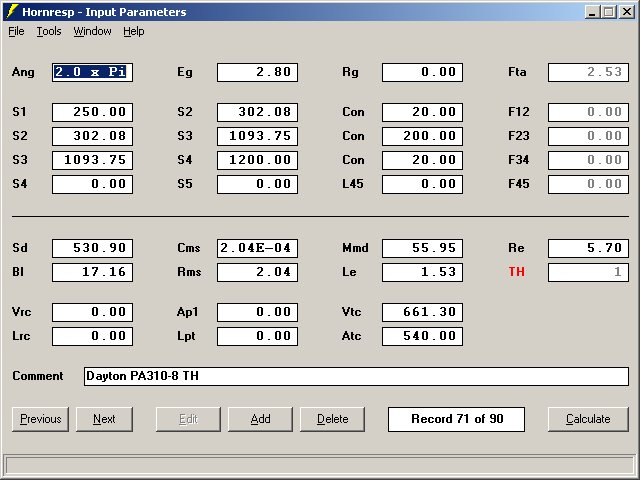

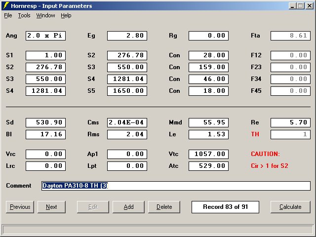

Published specs:
Vas: 2.89 cu.ft.
Fs: 44.4 Hz
Qes: 0.34
Qms: 8.63
Qts: 0.32
Le: 1.5 mH
Re: 5.7 Ohms
Measured specs:
Vas: 3.30 cu.ft. (need to confirm)
Fs: 39.0 Hz
Qes: 0.31
Qms: 7.50
Qts: 0.30
Le: 0.37 mH (!!)
Re: 5.2 Ohms
The low Le came as a big surprise. It's significantly different to the published spec. So much so that I measured the parameters of another driver with the WT3 just to ensure that it was still working (and measuring Le) properly (I got the expected Le for the test driver during those measurements). 0.37 it is.

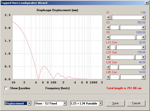

Published Xmax for the PA310-8 is 5mm, but some quick tests suggest that might be a bit on the generous side - the suspension seems to be applying the brakes quite a bit before 10mm p-p is reached and distortion quickly rises. On the plus side, I was unable to get it to bottom while driving it free air with low frequency test tones.

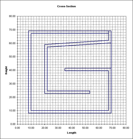

Here's the latest iteration I'm working with. It's a combination stepped and tapered TH. The cross-section drawing is the output from an Excel spreadsheet (still being tweaked) that I'm using to try to optimize the layout (using Excel's "goal-seek" function). Basically I put in a few parameters, select the "goal-seek" option, and it chucks out the cross-section in a chart. I could probably modify it to do a full-tapered cross-section, but that might end up in the path length being shortened a bit.
The question though is how should the path length around the corners be determined? At one time I thought that a simple arc would do it, but my measurements with POC #1 suggests otherwise, that actual path length lies somewhere between the arc length and the centerline (and closer to the latter).

I did some quick checks with my POC #1 and it seems that the "arc" approach results in an effective length measurement that's lower than what is suggested by the measured lower resonant frequency. I'll repeat the measurements this afternoon in a bit more detail to confirm this.

I repeated my measurements, using my POC#1. Here's a summary:
Design: tapped-pipe, c-section 290cm^2, split into four equal lengths of 51 cm, built using 0.75 in thick ply.
Design path length = 204 cm
Design Fb (from HornResp impedance data) = 41.5 Hz
Calculated path length = 199 cm (using arcs rather than center line)
Measured Fb (from WT3 impedance data) = 43 Hz
Hard to draw conclusions. I'm not sure what value HornResp is using for c, and it doesn't provide the option to adjust this. It should be about 347.8 m/s here, if this is different to what's built in to HornResp, then that's going to skew things a bit as well.
I'm going to switch my optimization calcs to use arcs, just in case 🙂.
I made the switch. Calculated horn length is reduced by a whopping 3%, resulting in enormous 2% increase in Fc. I'm not going to worry too much about it.

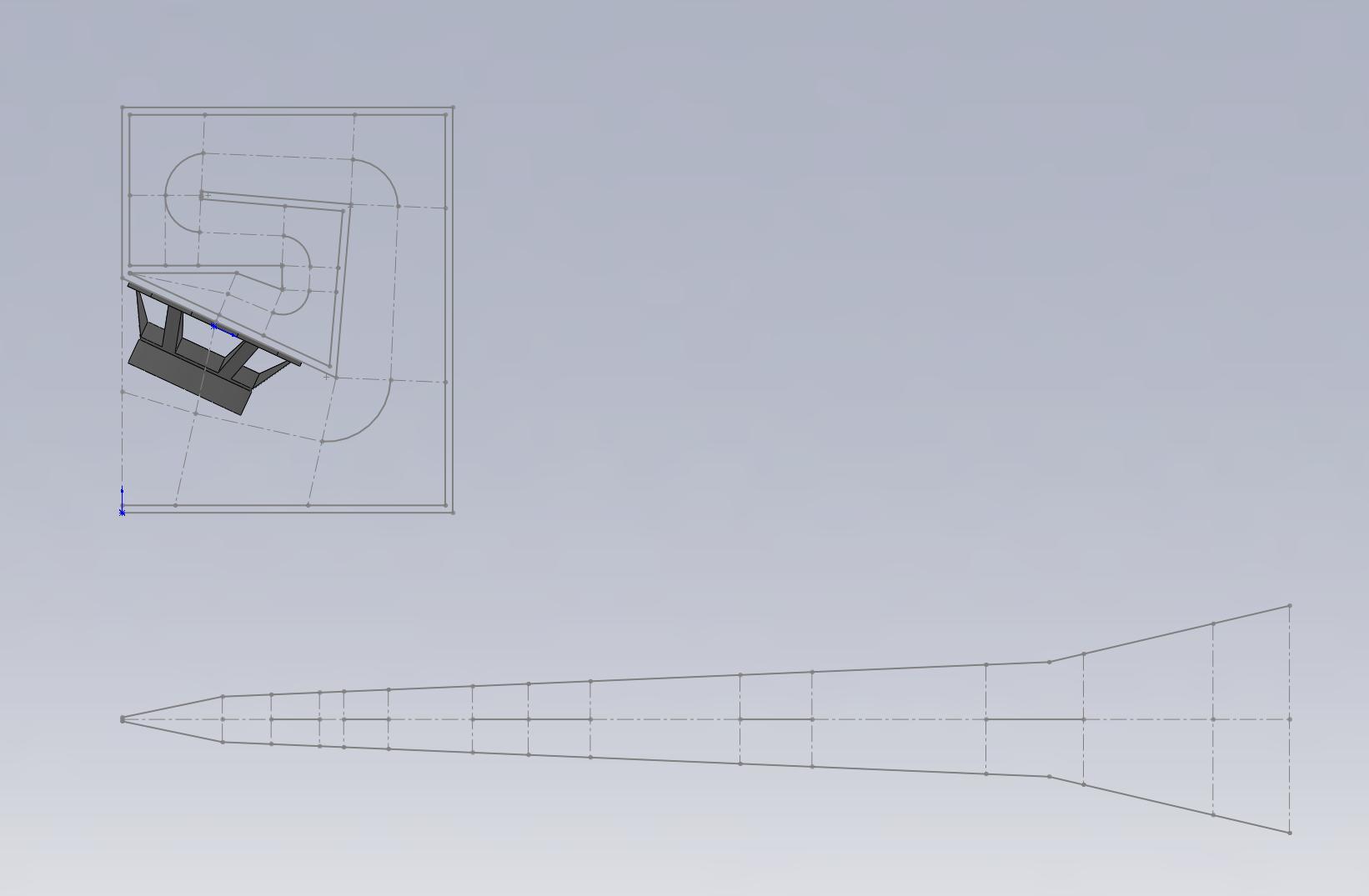

Brian
Regards the folding of you TH
Here is a possible layout that might suit.
This is a cabinet I am working on that has a horn that is a similar shape to the one in your first post.
I have used the small S1 dimension to make more room for the flared mouth, and have tried to minimise any wasted space.

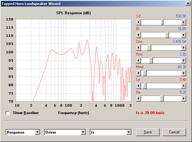

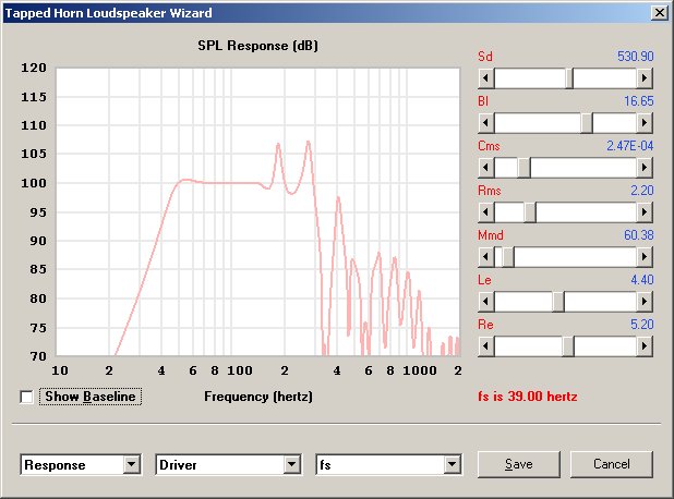

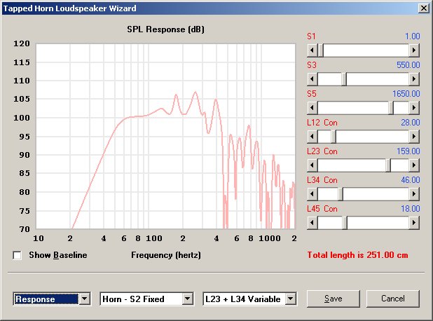

Effect of Inductance on TH passband...
The first image is a TH alignment with no inductor in series.
The second is the same TH alignment with a 4mH inductor in series.
The last compares the two responses.
Of interest here is the flattening of the TH's passband, particularly the apparent increase in SPL between the two main peaks.
In theory, based on the other TH observations made on this forum, the peaks and dips will likely be a lot less than predicted, which suggests that a lot less than 4mH of inductance will be needed to flatten the passband.
