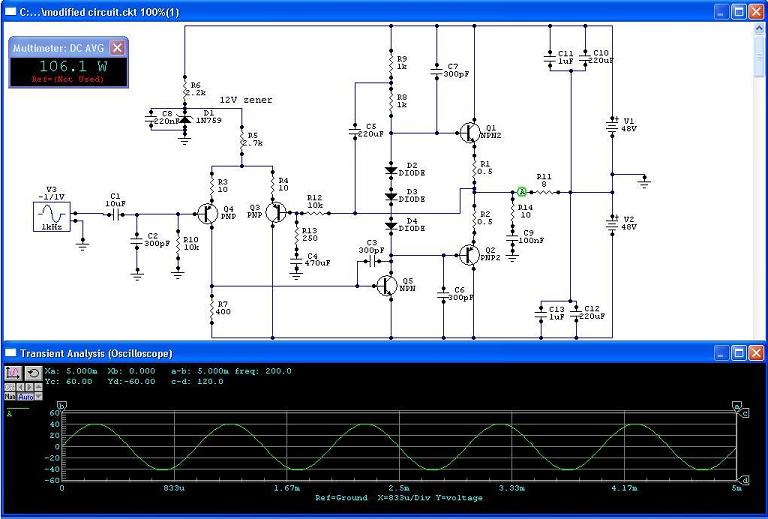

Hi all,
Some of you must remember me of one of my first threads about a year ago(http://www.diyaudio.com/forums/showthread.php?threadid=1138), it's about my first try to make an amplifier but unfornately it blew up several times, so I asked you to help me, and you did. But I stopped the project then because I was too impatient. I decided to start reading about how amplifiers work and how to design them. And I learned a lot of this site since then.
Yesterday, I took back my first (toasted) amp-pcb and I decided to redesign the schematic to delete the mistakes and to make it stable.
I just finished my first version, it ran smoothly in simulation, and I would like your comments on it.
NOTE:
*) I'll use in the future an extra pair of transistors (MJ15003/15004) after the TIP142/147
*)the diodes must be mounted on the heatsink and not in the excisting holes in the pcb
*)the same pcb can be used
*) maybe I'll change the value of the emitter resistors to adjust the quiescent current
*)I'll recommend a small heatsink for Q5
*)I'll use a potmeter of 2.2k for R7
*)all resistors 1/4W, exceptions:
R1 & R2 => 5W
R6 & R8 => 1W
R9 => 2W
HB.

I've changed all the 300pF capacitors into 100 pF caps, otherwise there will be distortion at higher audio frequencies.
And I tested what C6 in the original circuit does to the signal - I've never seen that big distortion, so I left it away.

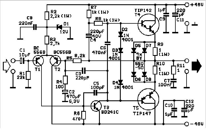

D5-8 is a rectifier bridge wired to bypass the 1 ohm emitter
resistors. Its purpose is to provide a low impedance path to
the load when the voltage across the 1 ohm resistor exceeds
about .6 volts. In this way, you can ballpark a bias voltage
across the resistor at less than .6 volts and not have the
bias current wander too much because 1 ohm is quite a
bit of degeneration.
Done properly, it's a viable technique, but it can be done
improperly as well.
I used it on the Threshold 800A, 400, and 4000, and later
I saw it on the "Barney Oliver Amplifier" which was an
n-house employee project at Hewlett Packard. You may
recall that Barney Oliver was a head of development at HP,
and was later deeply involved in SETI.
Yes, I was thinking about placing a cap over the bias diodes but a lot higher value than in the original circuit (470nF was too small), I think I'm going to try some different values and pick out the best.
I've made some changes to the circuit, there the original ran into oscillation of higher frequencies when no input was applied:
1) I've placed some 100nF capacitors over the transistors, and one at the input
2)I've lowered the input-impedance, and also the gain-factor by making the values of R5 and R1 equal to eachother (they must!!), and changed them to 10kohm.
3)I've placed 10 ohm resistors in the emitters of the diff.amp transistors, to handle differences of the two transistors.
4)I've changed the zobel network to the mostly used values
5)the diodes must be placed in better thermal contact with the output transistors, they are placed too far away on the PCB
6)I'm also going to use MJ15003/15004 and a bigger heatsink with a low noise fan on it.
7)I left the D5-D8 diodes away, the drills in the pcb I'll use later on to detect the voltage over the emitter resistor (for protectioncircuit, clipping-level detector, ...). I had to change the value of these resistors, and they must be 5W instead of 1W.
8)I'll use a trimpot for R6 (or R7 in the modification) there I remember there was once a DC-offset when I had changed that transistor
so what do you think about it?
HB.
Yeah, I've just read all the 120 replies (poehh 🙄 ), there are some nice ideas mentioned, I'm going to study how the inputstage with current mirror works.
back on this design:I still have the PCB and I think I will give it a first try today or tomorrow: the weather is too bad over here to go out (so time enough), I will add some flyback diodes to give extra protection.
If this works, I'll try to put a current source in the inputstage and maybe a current mirror (first have to understand that part).
see you later...
HB.
EDIT: I've changed the modification a little bit:
R3 & R4: 47 ohm
R13: 300 ohm (maybe a potmeter)
R7: potmeter adjusted at 650 ohm
input amplitude: 1,25V
please tell me if there's something wrong (could save me from the smell own blown parts 😉 )

The current in the input differential pair is about 2.1 mA in each device, so R7 must be approx 300 Ohms in order to obtain 0.6 V to the base of the transistor...I have explained this in one another thread.
I don't understand why C6 and C7, they will cause additional phase lag, and a second pole which can easily put your amp into HF oscillation. C3 must be the unique phase lag compensation for the whole amplifier. It is possible that you have to connect a small capacitor across R12, to cause a phase avance in the feedfback, in order to obtain correct transient response with capacitive loads.
Regards, P.Lacombe
IT WORKS GREAT!!!
Yes, indeed P.Lacombe,
I did test it an hour ago, and guess.... it just worked fine 😀.
so these are the last things I've changed before testing the amp:
I left away C6, C7, C2 (I've forgotten to place this one).
R3 and R4 are 47 ohm
R13 is 330 ohm
I've placed a 220 pF cap between the base of Q3 and the emitter of Q2 (same effect like placed over R12 ??).
I've changed the whole biasing thing into:
two diodes (2 x BYV29 - is easier to mount on heatsink) in series with a potmeter of 100 ohm, and a 470nF cap placed over these 3 components.
I've set the quiescent current to 100mA with the potmeter, checked again on DC at output (= 80mV). I connected my mixtable to the amp, and wired my speaker: worked fine at the first try. I've used too small heatsinks so I've placed two low noise fans in front of them, the temp didn't raise above 30 degrees I guess.
There is only one problem: the bass performance is excellent (I've used 2 x 37000µF) so my woofers are playing above the midrange speakers and the tweeters (I don't have this with cheap commercial amps 😉 ). When I turned of the amp the speakers kept on playing about 30 seconds (so the caps are huge enough).
Anyone idea how to reduce the bass performance, taking value of C1 between 0.1µF ====> 1µF ? I'm going to try that right now.
HB.
