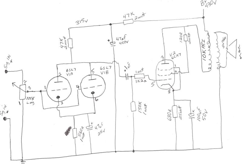

jaymanaa said:Please be brutal.
Ok 😀
Throw away that paralleled 6SL7 at the input and place a 6DJ8 SRPP 😉
Other possibilties are 6DJ8 in cascode-with-nfb, a CCS-loaded 12AT7, all those things followed with a cathode follower, maybe DC coupled, to gain overdrive recovery. You have food for thoughts now 😀
Aside from those kind of decisions, I would suggest a 470k resistor from the grid of the input stage to ground, in case the potentiometer looses contact (the amp will probably oscillate).
And also, from a 6CA7 you'll get 4W at those conditions. Use a 4800ohm load output transformer, it would be better. Or better, I suggest you remove the cathode bias (and implement fixed bias). With -43V on the grid and the 430V B+ you'll get almost 8W with 4800ohm output transformer.
I'm no expert yet but from what I've learned I would go for the parallelled 6sl7 (carefully selected tubes for balanced transconductance) instead of the suggested srpp😀
I follow Giaime where he suggests adding a 470k resistor + would swap the 150k output stage grid-ground resistor with 470k (didn't do the calculations but with a 0,1µ coupling cap and 150k resistor low-end will roll off early I think).
A lower output resistance opt than 10k (why so high?) and fixed bias sound very sensible to me too.
Lastly you might want to take a look at this method for triode-strapping pentodes; might regain some bass-firmness and overall attack: http://www.t-linespeakers.org/tubes/triode-trick.html. I'm currently waiting for the components to arrive to try this circuit; when going from pentode to triode-strapped pentode (in my case el84 se) the midrange becomes very lush and the sound loses overall attack. These traits apparently appeal to many but are overly coloured and soft for my taste - the linked circuit promises to restore some of the 'power'...

Thanks for the honest assesment an candid replys. That's what I'm looking for. The low PO and high OPT primary R are a result of going for least possible distortion with enough power for personal listening requirements. I'm not sure if 4 watts will be enough, and if it turns out that it is not, I will definately look into lower R Pri. BTW I took a look at your site. Very cool, and interesting stuff. I plan to return to it when I have more time to really look at everything. Thanks for your replys and suggestions, Jay
Oh BTW, the log pot will be replaced with a fixed resistor on completed amp.
Klimon said:would swap the 150k output stage grid-ground resistor with 470k (didn't do the calculations but with a 0,1µ coupling cap and 150k resistor low-end will roll off early I think).
In that case, increase the capacitor, NOT the resistor. That resistor has a maximum value, if you put higher than what's specified in the datasheet the tube might go in runaway and destroy itself. In this case the maximum allowed is 700kohm, as the datasheet says, but an excessive value might cause trouble with new production tubes. My suggestion is to avoid increasing it over 220k.

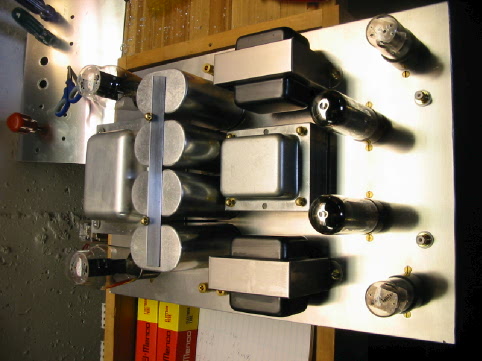

Points well taken. This resistor value has come up as a topic with some other tuby friends of mine. This amp is my first, so I'm expecting (and looking forward to) some tweeking once I get it going. I have wondered about the .1 cap value quite a bit. I'm building the amp fairly large to accomodate some very generous iron and to also make changing passives easier. Here's a pic. Thanks and I'd love to hear more ideas, Jay
Reducing the resistor's value is the impetus behind using a grid choke on an output stage as far as I know. If I remember correctly, it has to do with the voltage appearing across it when grid current flows.
The capacitor is cutting in at around 10Hz. Increasing it significantly may not be in the best interest of overload recovery. The capacitor charges when grid current flows. Many amps use values like this. YMMV, and as always, it's a matter of taste.

Thanks for the good advice folks, she is singing beautifully. Much special thanks to Indm who has helped me allways, ever since I took up this madness. Also to tubes4ever who drew the original schematic and put it on a very well done web page to share with all. You have some very fresh and exciting ideas about tube audio IMHO. Just a BIG thanks to everyone, Jay
The amp that I have been working on uses a CCS loaded 12AT7. I couldn't get enough gain with a resistor loaded triode, ANY triode, I tried a bunch, including the 6SL7 (but only one triode, not paralleled).
The rest of my amp is very similar to your design. I am using cathode bias, with a 560 ohm resistor and a 1500uF cap. It works fine, no overload issues. I have a 121K ohm metal film grid leak resistor. Coupling cap is .22uF. Stopper is 1K. Yes, add a resistor from the grid of the input tube to ground, value is not critical, but use a good quality part (I have 220K). A small stopper would be a good idea also (I have 150 ohm).

Awesome website, I have visited often. I like different stuff. It just makes sense to me to try new ideas. My OPT's were wound at Heyboer and are closer to 9K. I was a little concerned about to little output power so I fudged a little on tubes4ever design. I'm using Heresy's right now and it seems like it will have enough power for most of my listening. The bass is very impressive. Haven't done any real testing yet, just listening. This is the first single ended amp I've ever heard, and I must say I like it. I'm allready thinking about DH. I'll be looking forward to following your test's and will report my findings also. Jay
