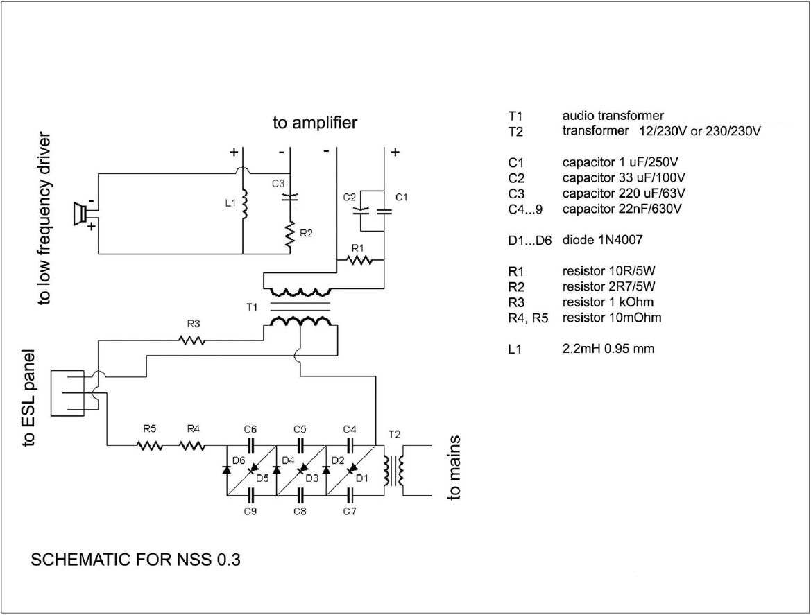

If you can find and post a schematic, that would be helpful in devising a troubleshooting procedure. Final uses an "inverted" charging arrangement so troubleshooting would be a bit different; although, same operating principles apply. Sorry I can't be more help but I have limited experience with electronics and no experience at all with the Final's arrangement. I read somewhere that the diaphragm coatings tend to deteriorate on the Finals over time. My guess would be either a weak diaphragm coating, a corroded bias supply/diaphragm contact, or a failed bais supply. Hopefully, someone more knowledgeable than I can post a diagnostic procedure.

If you can find and post a schematic, that would be helpful in devising a troubleshooting procedure. Final uses an "inverted" charging arrangement so troubleshooting would be a bit different.
The Final 0.3 is one of the older models that does not use the "inverted" arrangement.
It uses the more traditional constant charge setup with a resistive diaphragm coating.
I have a schematic floating around somewhere…will see if I can locate it.
here could be the owner and service manuals of the Newton NSS0.3 if file size weren´t too large 🙁
Attached are the schematic and compressed versions owner/construction and service manuals for the Newton NSS0.3
The schematic looks identical to the Final 0.3, although I seem to recall it had 8 stages in the voltage multiplier, not 6 as shown.
