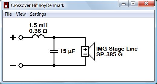

thanks for posting! A little surprised he used two as the sensivity of the horns/tweeters he used is over 100dB and the woofer is 96 😱 But seems like he has made the crossoverfrequency at 2khz 🙂
A crossover closer to 1 kHz certainly would be better for a 15" woofer. I'm not familiar with PA tweeters, but 2 kHz is probably more realistic.
Attached a simulation of the woofer in a 104 liter vented cabinet with a basic crossover at 2 kHz. Not 100 % Hifi correct, but it works. 🙂
Thanks alot! I might try to fine af tweeter that goes closer to 1khz or at least 1,5khz 😉
Lets say i find one that goes to 1khz. What values should the crossover parts have then? With 1,5khz it i would imagin it would be in between 😉

Firstly, let's say we are not PA experts here. 🙂
I'd trust Dissi with his bass filter there though. I would be thinking something between 1.5 and 2kHz is the right crossover point too.
