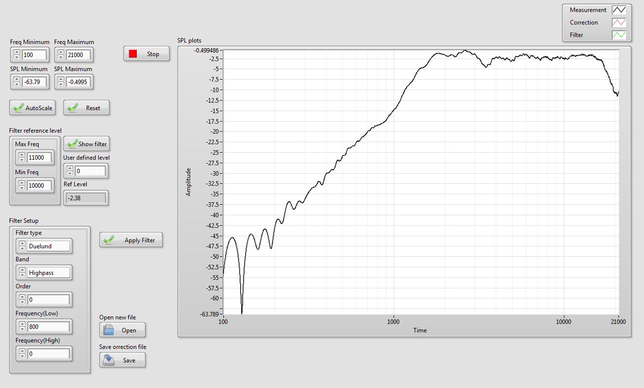

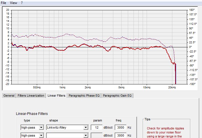

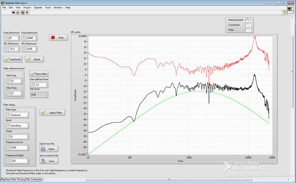

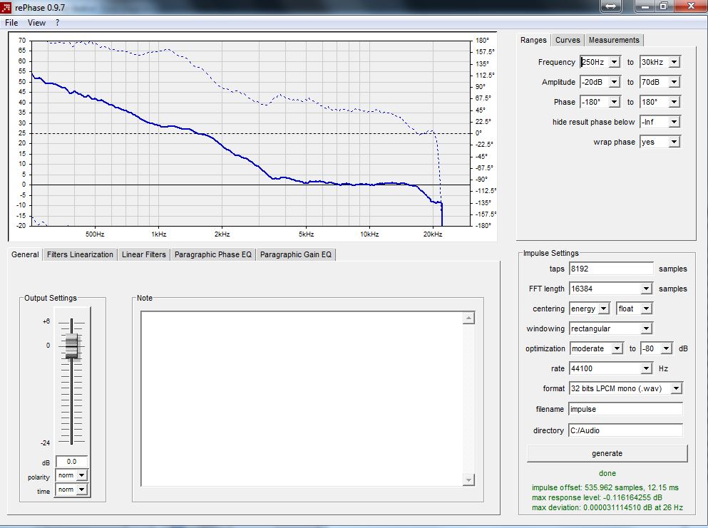

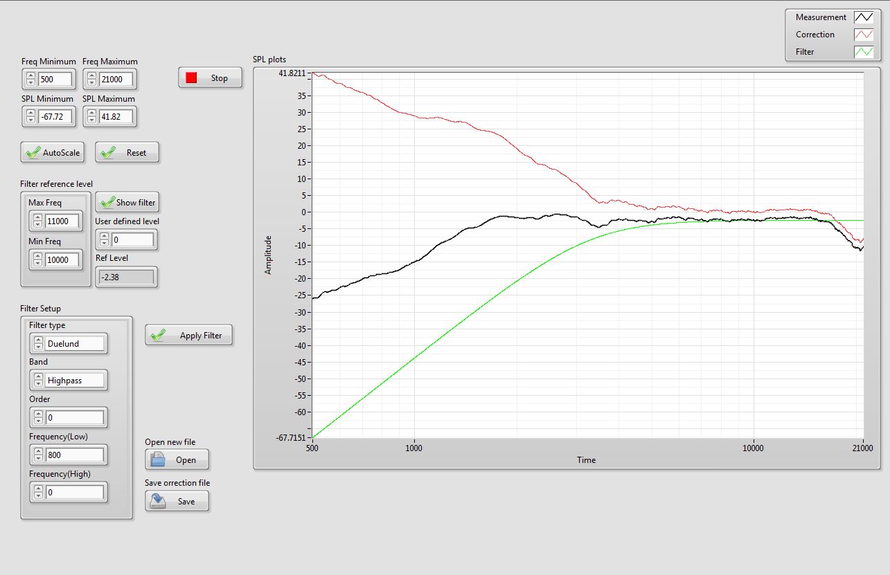

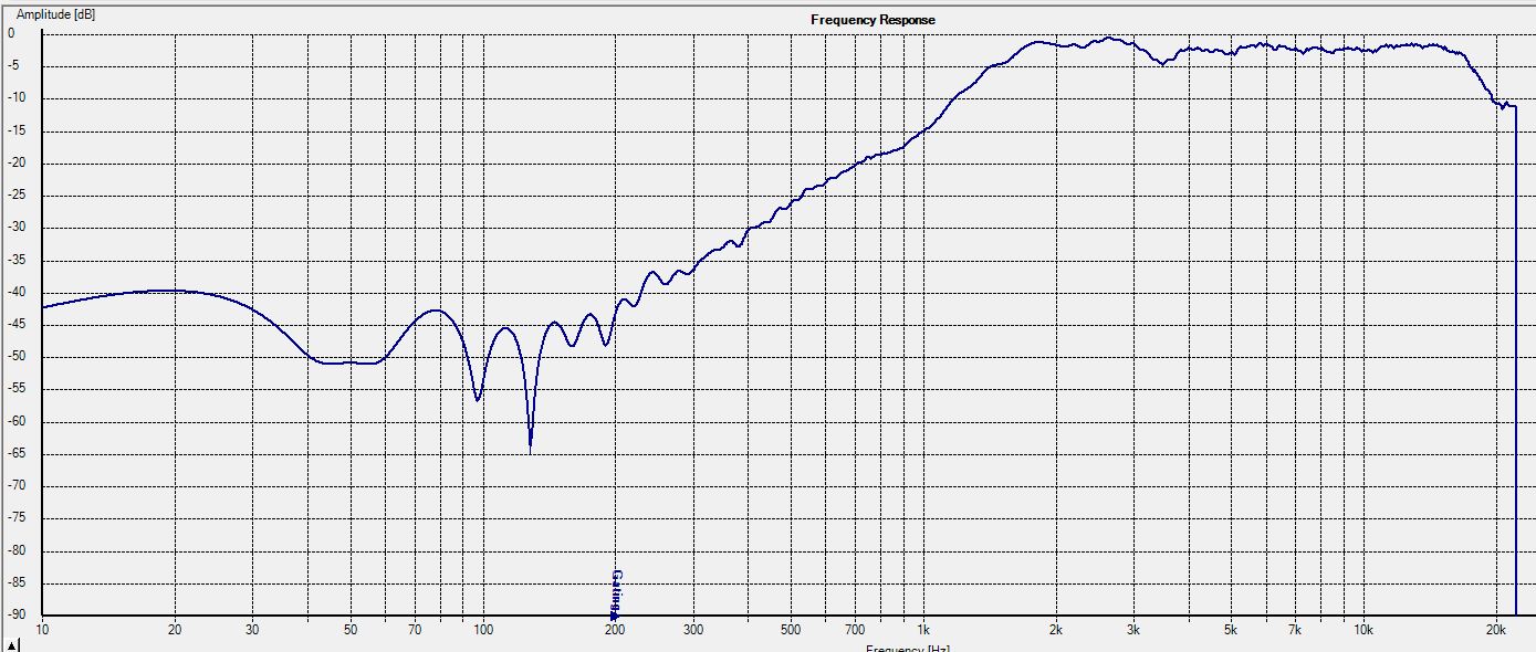

I'm doing a small tool which can help generating filters in Rephase, (Alocator also planned).
Just a few screenshots:
(The Duelund filter was not properly calculated at the time)
Create a measurement in Holm and export it:
Import the response to the tool:
Choose the desired filtertype and frequency, the compensation curve will now be calculated, and can be exported:
The filter now can be loaded in Rephase:
Now use standard filters, phase EQ etc. to get liniear response:
Afterwards the measurement can be loaded into the tool to verify the filter:
It can also be used to check if a filter type will match the actual unit etc.
The tool will be freely available, if someone can see the use of it 🙂.

Hi Lgrau,
Nice software, the interface looks neat !
I see that you are using rePhase v0.9.7
You should give the newer versions a try (currently 1.0.0): since version 0.9.8 there is a new "compensate" functionality in the minimum-phase filtering tab that can be used to achieve similar results within rephase.
