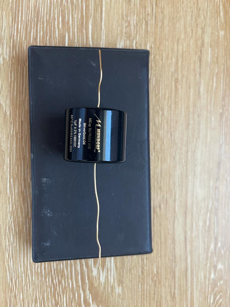

Why do Film Capacitors have a short and long leads. Do they have any significance? If so, could someone please advise?
Also can someone assist in mentioning the simplest way to determine the a film capacitor's outer foil ?

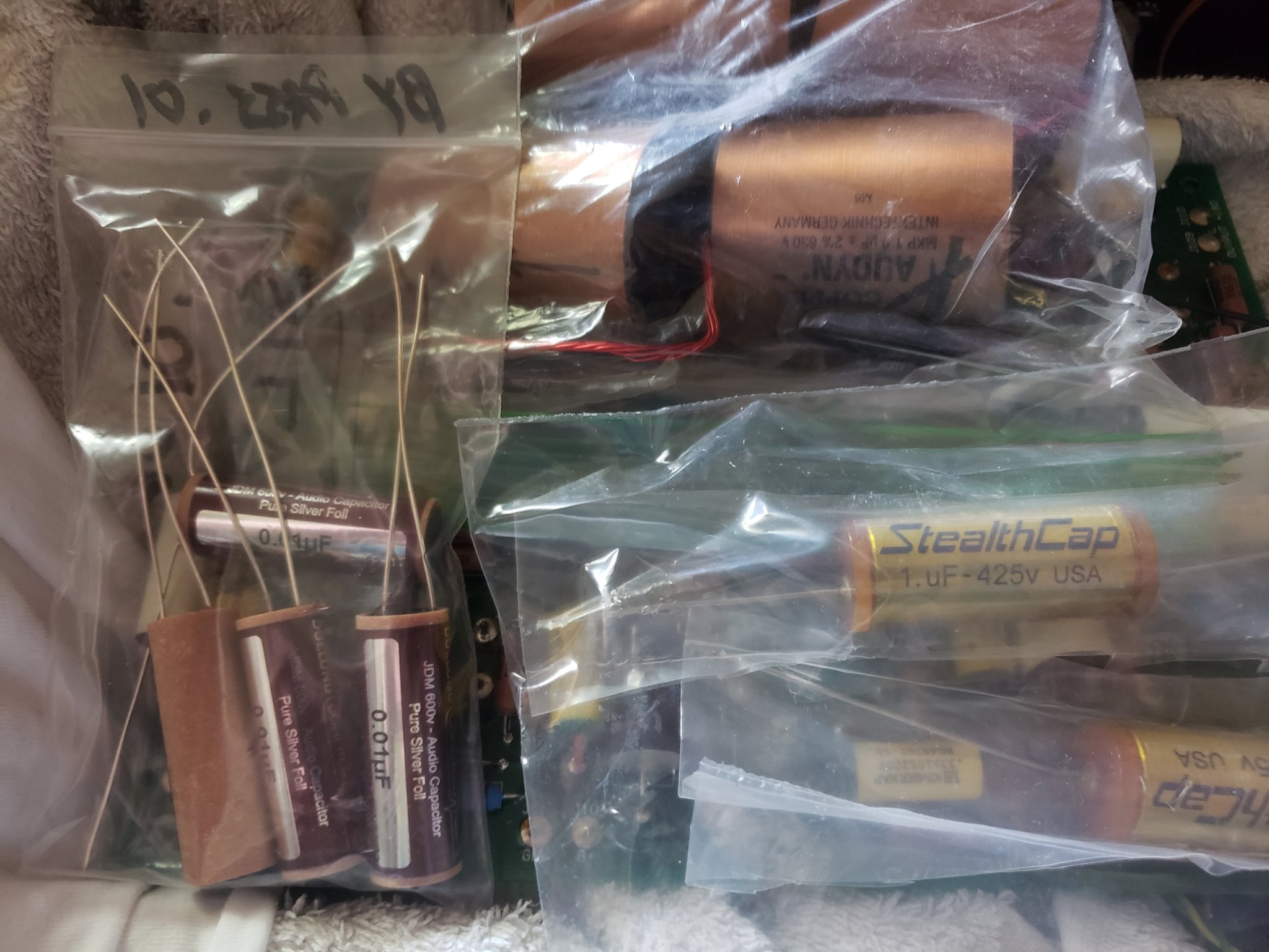

I just went through a pile myself for a/my Cary SLP-05 and a second V12r I added to the mix.
Have fun.
