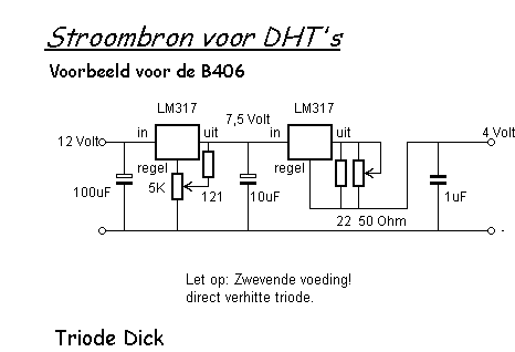

is it allright to run the filaments at 14.2 V even if in the data sheet states 13.3 V?
The datasheet should state 13V (AC or DC) at 300mA.
The P series are normally used in series string hook up with other valves, the voltage isn't too critical but the current should be held constant.
So ideally you should use a regulator a voltage regultor followed by one with current set to 300mA.
Something like this should work for DC heaters:
Cheers,😉

Frank, thanks for the schematic.
If you want to reduce the voltage further I'd put a 1 Ohm resistor in each leg of the AC heater feed.
P series valves aren't too critical about the voltage as they were meant to be put in series with others to form a series string.
As long as the total voltage supplied added up and each had 300mA to burn away it usually worked fine.
Cheers,😉
