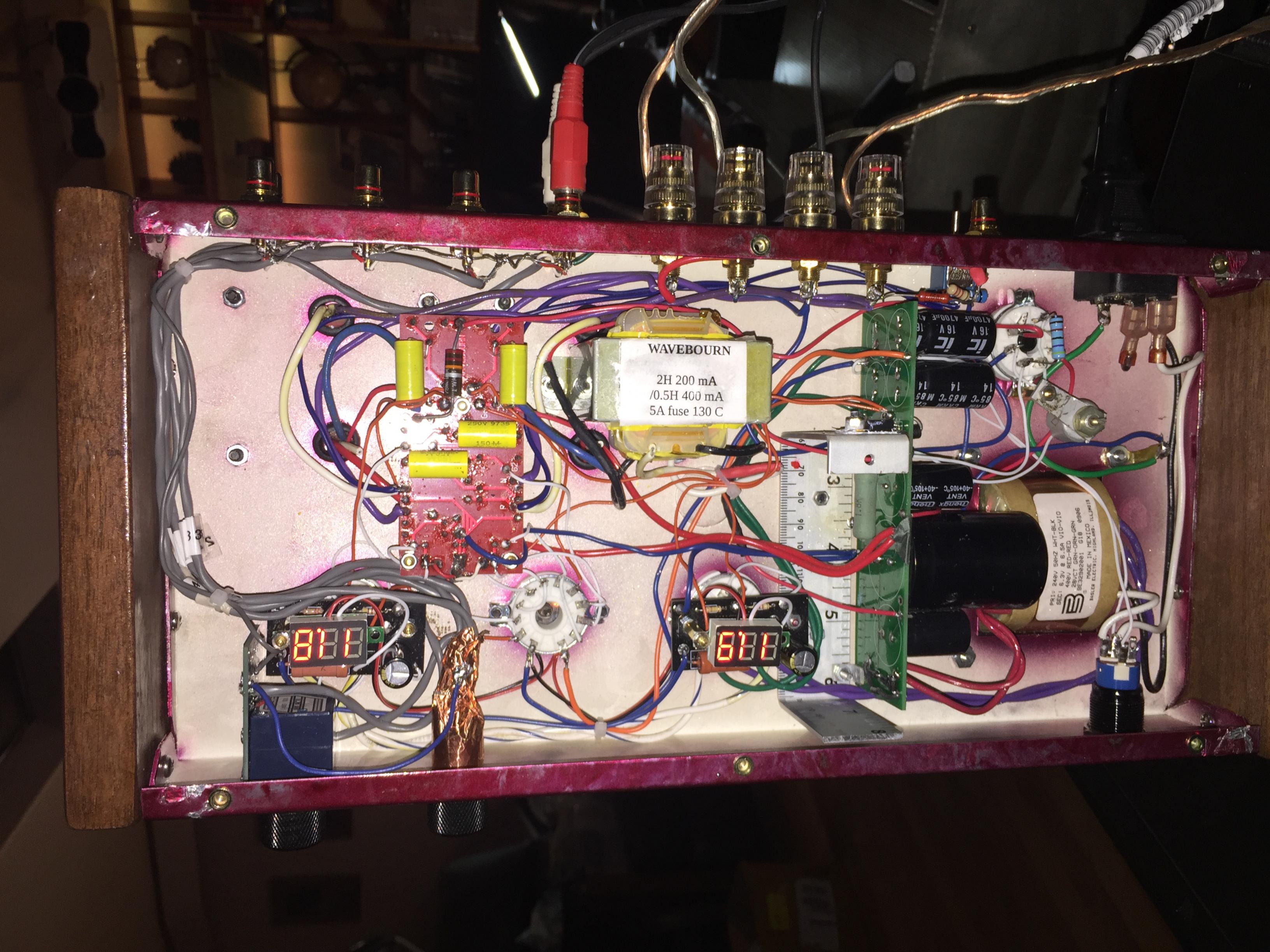

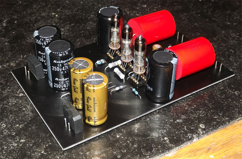

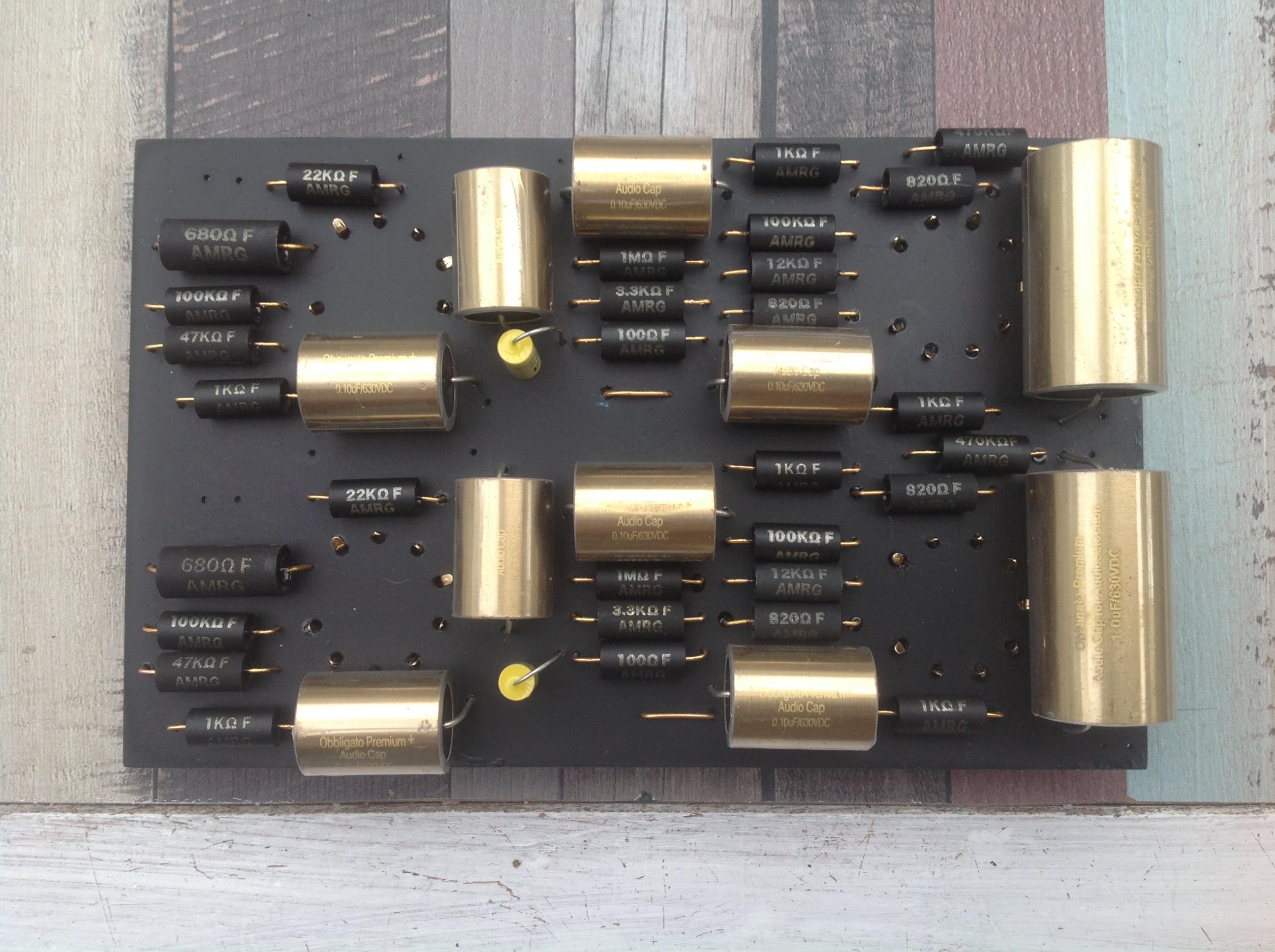

I never put tube sockets on PCBs, it is unreliable. Tube sockets must breathe, so I connect them by flexible wires to PCBs.
The sockets I buy from Cricklewood Electronics have quite long leads on them so there is room for expansion and contraction.

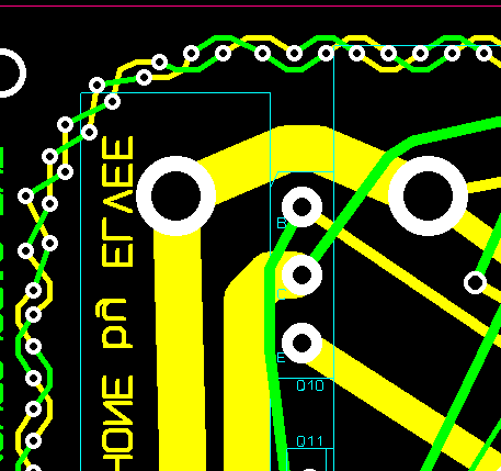

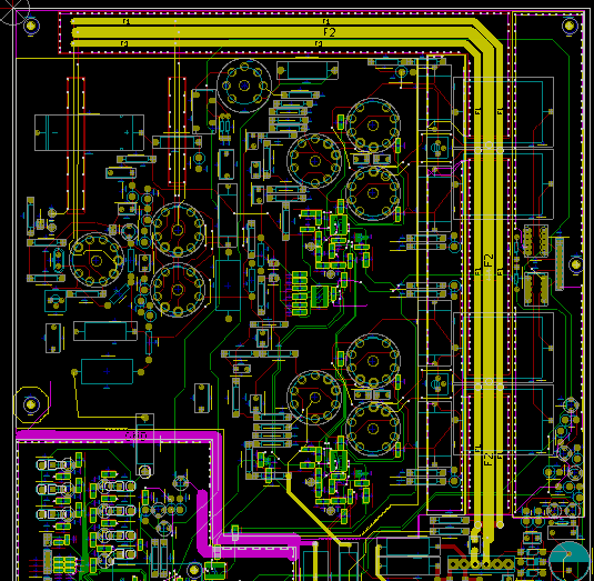

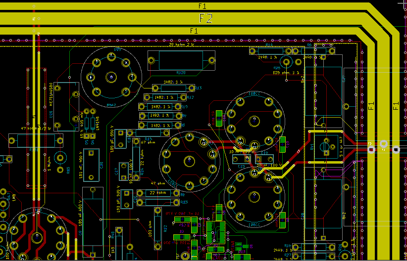

You can get some compensation of magnetic fields by making two loops with opposite directions using three tracks: F1-F2-F1.

@Wavebourn:
"I never put tube sockets on PCBs, it is unreliable. Tube sockets must breathe, so I connect them by flexible wires to PCBs."
Can you supply a photograph of this solution please? Will be very interesting for me.

@MarcelvdG:
"You can get some compensation of magnetic fields by making two loops with opposite directions using three tracks: F1-F2-F1."
I think I understand what you mean: Suppose three tubes
then connect from filament supply : f1(T1) to f2(T2) to f1(T3) and back f2(T3) to f1(T2) to f2(T1) back to filament supply?

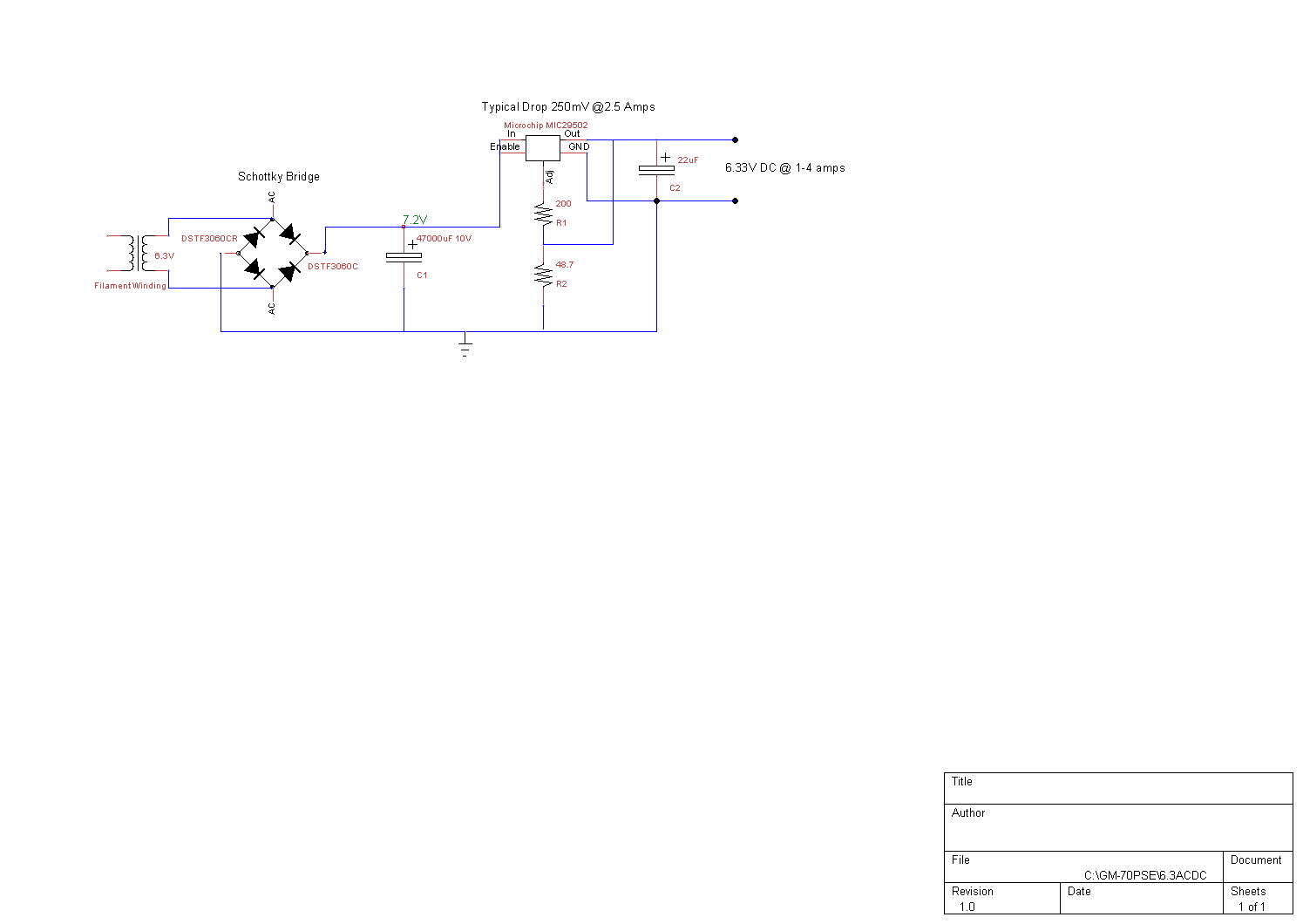

Just use DC heater supply at sensitive amps like phonoamp and with linelevel or poweramps single side pcb AC heater supply never a problem.
"I have build a lot of tube pcb's. Never had problems with heater supply on pcb.
single side pcb AC heater supply never a problem."
Well, that never occurred to me as a possibility, but is worthwhile considering!
Only it needs extra circuitry to get that done in stead of a simple extra transformer heater output.

@Wavebourn:
Thanks Wavebourn for sharing your picture. I now understand that the tubes are not part of the pcb but mounted sideways of separate pcb parts and hand wired.
That is of course an option also.
@MarcelvdG:
That may be a good idea, but it is not what I meant 😉

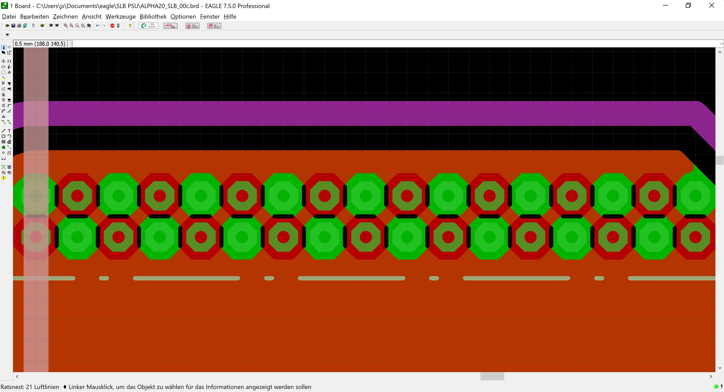

Attached are two layout plots of a valve DAC I made some time ago. The total heater current is about 2.7 A, so I made relatively wide traces around the right and top part of the PCB with an F1-F2-F1 layout. The magnetic field of the left loop (F1-F2) is supposed to cancel the magnetic field of the right loop (F2-F1).
I tap off these big wires at various places and do the hook-up from there to the adjacent valve sockets with simple narrow traces placed close to each other to keep the loop area small (although at some places there is a trimmer potentiometer in the way). It's a pity that there is no cancellation of fields exactly where the wires are the closest to the valves, but then again, twisted wires in a chassis-built circuit also usually miss a few twists right next to the valves.

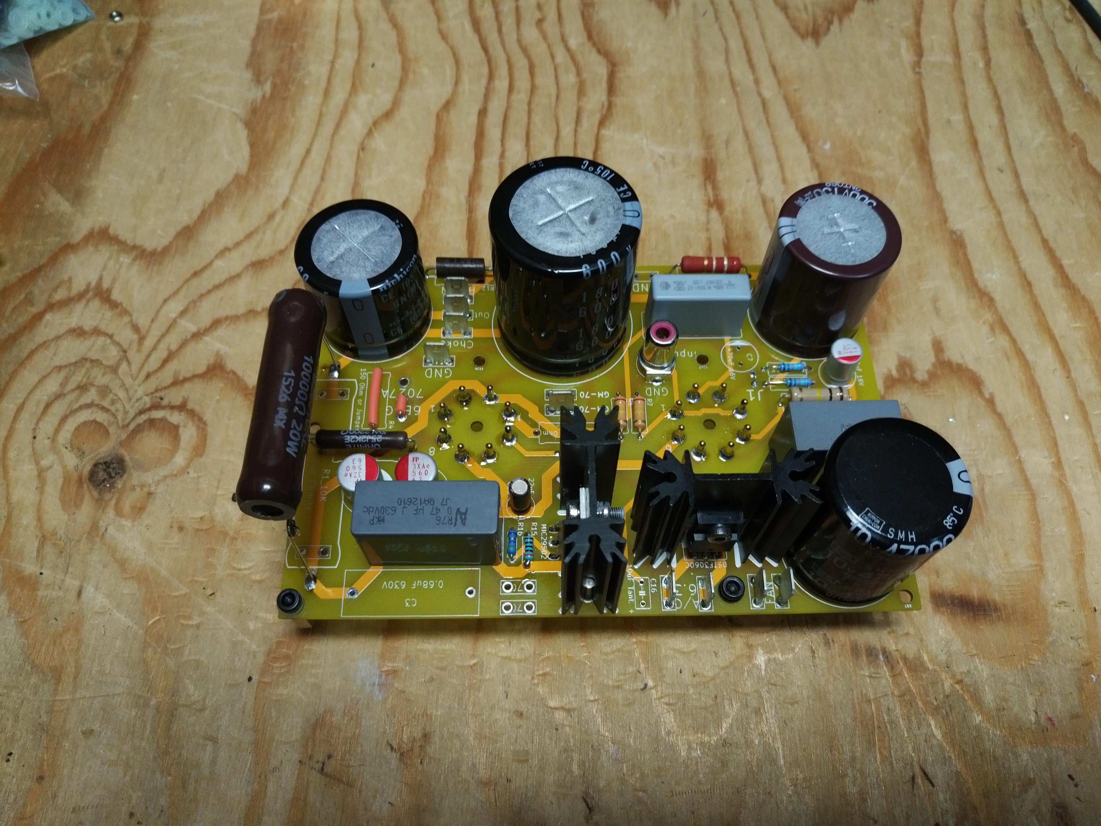

I've built 4 with PCB's so far. And with traces on the board for heaters I go DC as well and have had zero hum problems. The board I'm using now has eyelets right next to the pins on the socket for the heaters. So AC with twisted pairs should be ok to use. Some of these new boards are pretty well thought out. The one I'm using this time can be tweaked for kt77, 6v6, 6l6 or el34 tubes. It also has schematics for several power supplies using SS or tube rectifiers.
