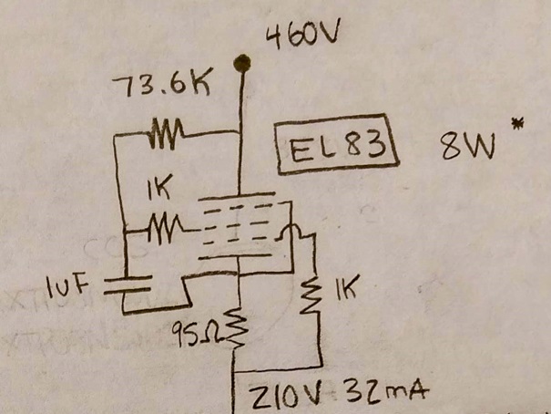

Here is what I came up with as far as PSRR and ripple goes on the supply, not including any potential coupled 120Hz noise from the filament raw DC supply.
First, here is the EL83 pentode CCS loading the 45:
So looking at PSRR, the AC impedance of the EL83 CCS is ~57.8k at 120Hz.
The ra of the 45 tube is 1650ohm, so:
PSRR = (RL + ra )/ ra = (57.8k+1650ohm) / 1650ohm = 36 = 31dB
With my power supply in PSUD2, I am expecting ~2mV rms of ripple at the top of the EL83. So, the ripple I would expect on the plate of the tube would be:
2mV rms / 36 = 55uV rms
This will be further stepped down by my 24:1 OPT, resulting in:
55uV / 24 = 2.3uV rms headphone output
In my supply, ripple off the resevoir cap is about 2V rms, then down to 2mV post CLC filter (60dB attenuation), then 31dB down across the EL83, then another 27dB down across the OPT.
With all that being said, not sure what kind of voltage I can expect from 120Hz coupling from the 6.3V / 5A winding, but I think it would have to be pretty significant to overcome 118dB of attenuation.
Does that make sense, audiowize? Thanks again for your input.

6A3 - thanks, right now I am looking at 2.3uV rms ripple on the headphone output according to PSUD2.
What I did above was to see what kind of 120Hz noise attenuation I can expect across the power supply filtering, output tube CCS, and OPT, the reason being I might include my 6.3V / 5A filament windings on my mains transformer (as opposed to dedicated transformers), and there is some concern the rectifier noise from the raw DC supplies might couple to the B+.
