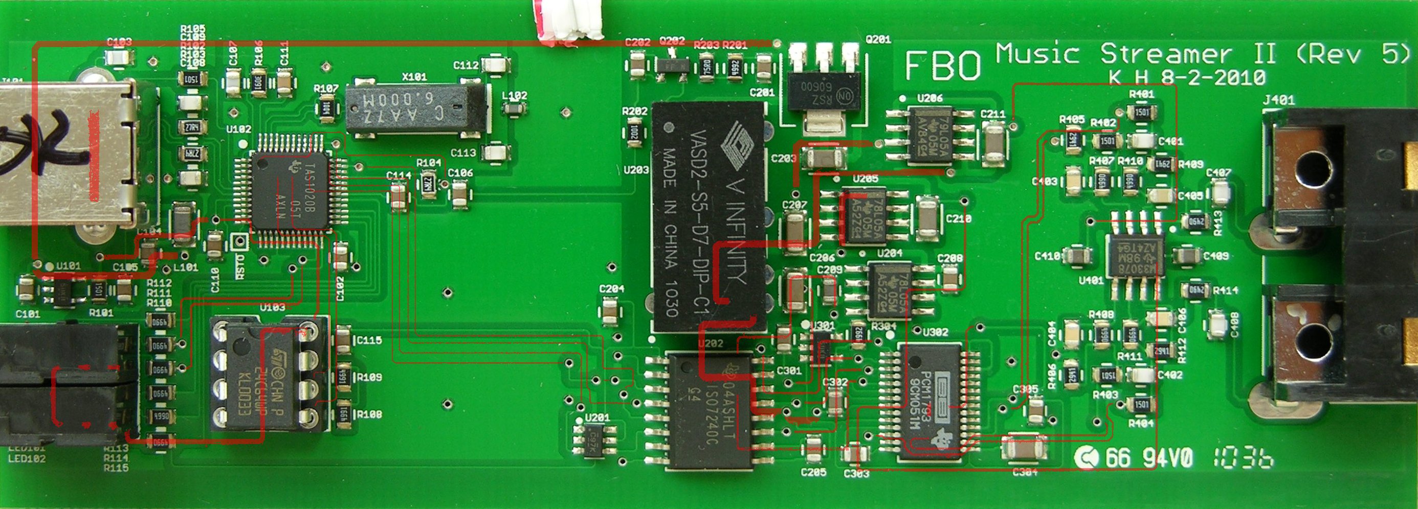

I recently bought a HRT Music Streamer II, and I'm really curious to figure out how exactly it works. I've taken some fairly high resolution pictures of the PCB, both front and back. I've then succeeded in superimposing the traces from the back of the PCB onto the front picture of the PCB, so I can see where connections go between the components. I'm attaching this picture here, the semi-transparent red lines are the traces from the back of the board.
One thing I can't seem to figure out is where the clock is, is it the one marked "C AA7Z 6.000M"? I can't find anything searching Google for this.
I know the TAS1020B chip is the chip responsible for the asynchronous USB trasnfer, and I can see that the chip marked "24C64WP" is some kind of ROM, do you think this is where the firmware for the TAS1020B chip resides?

YesOne thing I can't seem to figure out is where the clock is, is it the one marked "C AA7Z 6.000M"?
YesI can see that the chip marked "24C64WP" is some kind of ROM, do you think this is where the firmware for the TAS1020B chip resides?
Thanks for posting the picture, always interesting to see. The output opamp is one of the cheapest ones they could possible find, replace it with a NE5532 and it will be 100 times better 🙂
Would you happen to have a link to the datasheet of the clock? I can't find anything searching for that string. Also, do you know what the 6.000M refers to? Certainly not 6.000MHz, right? I figure that'd be useless for 44.1kHz to 96kHz.

I'll try and answer Runek's questions...
1) The 6.000 is a 6.000MHz crystal oscillator. It doesn't matter what digital audio bit rate the processor supports. The TAS1020 is a microprocessor, it needs a clock in order to perform its work. Don't bother searching for a datasheet - it's a generic SMD crystal, most likely of the 20-50ppm type. See Epson MC-156 series as an example.
2) The Streamer II Plus has 4 NE5534's because it uses the PCM1794. The PCM1793 is fully integrated and generates an analog output signal, so a simple buffer is all that is required. The PCM1794 requires an external IV (current-to-voltage) stage and that's takes 2 NE5534's for each channel.
Have fun...

Thanks Arius, good explanations. Wrt. to the 6 MHz clock, I guess I was just looking for the clock for the output stage, so the 6 MHz didn't make sense, but now I understand.I'll try and answer Runek's questions...
