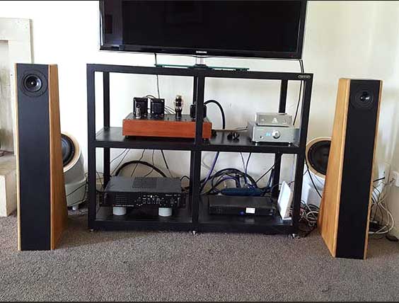

If you could get your hands on some SDX7, that'd be my first suggestion. They work like a charm in small sealed boxes, and are in fact the units seen in photo Dave posted above of the Ellipses - TMM with A7.3. But as those are now rather hard to find, something like the SB Acoustics 20PFC30 might be worth looking at - could be a new sleeper in the 8" woofer class, and cheap enough that a stereo pair with LP around 100-120 Hz, could still be in a comfort zone? I tend to prefer a HP on the wide-band driver in such configurations.
In the backgrond you can see a pair of triangular prisms (in the bottom frame). These are deflectors/stealthWoofers for the FH3. They have a single SDX7 firing towards the wall.
These are the easier to build 90° triangles and about 14 litres. Moving to a more acute triangle — i have drawings with 75° — gives more volume without getting excessively wide, but are harder to build. 75° is IIRC what Ron suggested as optimum for deflector use.
The little cubes on the floor are also SDX7, each with a Foster plate amp (12” cube external, about 14 litre for the SDX7).
I have been (very) slowly and intermittently working on th enext generation… with the revival of the SDX10, a 75° prism for 1 of those looks very doable for the FHXL.
dave

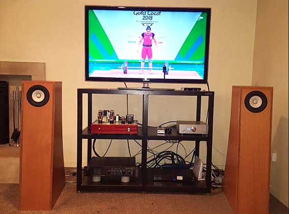

I have had the remarkable luck to chance upon a pair of FH3s and FHXLs built by two mad keen audiophiles in New Zealand, and selling them within a month of each other, so I snaffled both!
The babies came along first, and I was struck by them right away. They're really lightweight physically but not actually, their tiny CHR-70 drivers producing genuinely surprising bass. I literally plonked them down where my previous speakers were - BIBs with FF125wks - and they sounded tonally correct right away. The CHRs take a bit of driving though, and I picked up an Ice Power amp (47wpc into 4ohms) which made them come alive (my 5wpc 6A3 wasn't quite doing the business). I've had better staging and imaging from other speakers but then these are tiny drivers.
As mentioned, along came the opportunity to buy some FHXLs, some of the first built and the process was detailed here on DIYaudio. Anyhoo, they just arrived yesterday (drivers were sensibly sent separately) and they're a big step up on the FH3s, worth the effort and cost I believe. The reality is that the footprint is not much bigger; mainly they're wider. But they are also more real in the way they depict the music. The A10Ps are very smooth to my ears, the bass is angelic (my powered subs are now in another room) and these just seem to make music. Even the bad recordings are good. Better staging and imaging for sure. Just more realistic overall. I prefer them to my BIBs too.
Next test is to hook up the tube amps and see how 5-8wpc drives the 88dB sensitive AP10s.

The good thing about the FH3 is that it seems to be able to accept a wide range of small full range drivers.
Dave: Is there any you'd particularly recommend? Enabled or otherwise?! You (and Chris B) have probably heard as many of these as anyone else.
PS Glad to see you are on the mend. Many don't even make it to hospital with what you had, let alone live through it.
As does the FHXL (a size larger thou). A10PeN is my personal favorite thou.
I very much like what EnABL does to the already very good A7.3 — better small detail, better image/soundstage. A7 MOAP are in the same league, maybe a bit better. I have aquired Chris’ pair and will EnABL them at some point.
