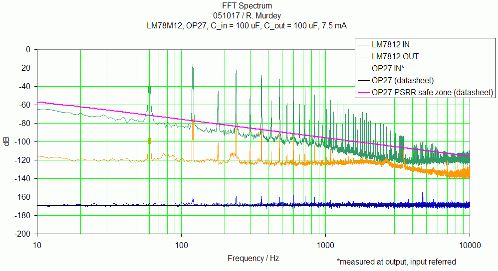

At some point I will get around to doing some more rigorous experiments. For the meantime, here is some real world data.
Basically, a Hitachi-branded LM78M12 clone drives the positive power pin of a Burr Brown OP27. The regulator has 100uF on the input and output terminals and the current draw is 7.5mA. The power supply is unregulated.
The amount of ripple is read from the height of the 120Hz peak on the plot. Going into the regulator it is -16dB, on the output it is reduced to -72dB. The ripple rejection of the regulator is about 56 dB.
The green line shows the unregulated voltage. The measurement limit for this trace is 120dB, so the noise baseline above 1.3kHz is obscurred.
The orange trace shows the regulated voltage. Taken at a higher gain, the measurement limit is about 140 dB (plus some broad spikes at visible at 80Hz and 210Hz for example), so the drop in the noise floor at 1.3Khz is real - though some of the peaks visible are not.
The blue line is the output noise from the OP27, referred to the input to make it comparable with the datasheet noise figures, shown as the straight black line. The output noise is equal to the op-amp noise, except for some ripple... seen as the small peaks at 120hz and multiples of.
The pink trace is the datasheet PSRR projected over the opamps input noise. Above this line, power line noise will detected in the output, below it, not.
So you can see that while an unregulated supply would not be a good idea, the LM78M12 would be acceptible here if a little more filtering as made available to reduce the ripple before the regulator. The noise floor of the regulator is well below the limit of the PSRR at all frequencies up to 10kHz.
I'm making no comments at all about sound quality. This is just a measurement of the noise. Above 10khz, too, the situation is unclear.

PS. measurement system: National Instruments PCI6229 multifunction DAQ. 16bit sampling, +-0.2V input limit (1V limit for the Vin trace) 250kHz sampling rate.

For the sake of completeness, I should add that the negative rail of the OP27 is powered by a JRC 7912A and 100uF caps on the input and output. The harmonics on both the positive and negative rails potentially contribute to those seen on the blue trace of the OP27 noise.
The plot is intended only as a qualitative demonstration of how much noise exists on the power supply rails before and after 78xx regulation, how much of this noise is attenuated by the opamps PSRR, and how this compares to the intrinsic noise of the opamp itself.

I noticed that OP27 lets through all the even harmonics of 60Hz. Even though the odd harmonics are about 20db down they do not show. Any reason?
What is that artifact @4700Hz?

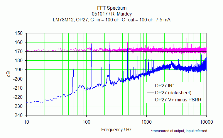

All the noise from the LM7812 output is technically present on the output of the OP27, but only the highest level peaks are stronger than the voltage output noise of the the op-amp itself.
In the plot below, I've subtracted the PSRR from the measured noise of the LM7812 output to simulate what it would look like at the output of the OP27. You can see that most of it is buried at least 10 dB below thw OP27s intrisic noise floor, and invisible so far as the measured output noise is concerned. In general there are more harmonics visible on the measured output than are predicted from just looking at the regulator output - this isnt surprising, really - but the correlation is pretty close, nonetheless.
/R
Dont know what the peak is at 4.7khz, or if its anything at all.
/R
