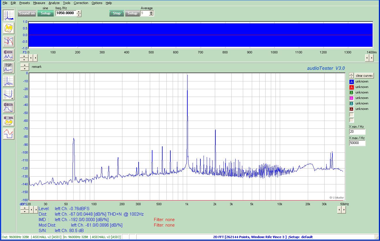

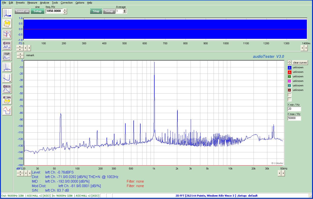

Over the holiday I have taken off on another tangent instead of building an amp.
I was trying to get better measurements of tube distortion so I can sort the used tubes I have on hand. I'm focusing on triode strapped pentodes including 6CB6, 6EJ7, 6J51P, 6JC6 and 6J9P.
I built a test box with :
(1) FET with Zener regulator to help filter the B+ comming in
(2) Switch Selectable tube anode loads of FET/Bipolar current source, Cascode DN2540 current source, and Gyrator.
(3) Fully bypassed adjustable cathode resistor.
(4) A Current Source Loaded FET Source Follower to buffer the output signal.
(5) DC input for cathode heater supply
This combination allows me to get measurements that seem to be 20dB better than I had previously made. The two screen shots show examples of previous and current measurements.
Is the data presented in the second FFT realistic for such measurements?
Is the distortion level in line with what should be expected for a current source loaded triode strapped pentode with fully bypassed cathode resistor?
Is the background noise level what should be expected?
In other words am I getting true representative data or do I still have a way to go to be able to accurately measure tube distortion and S/N ratio?

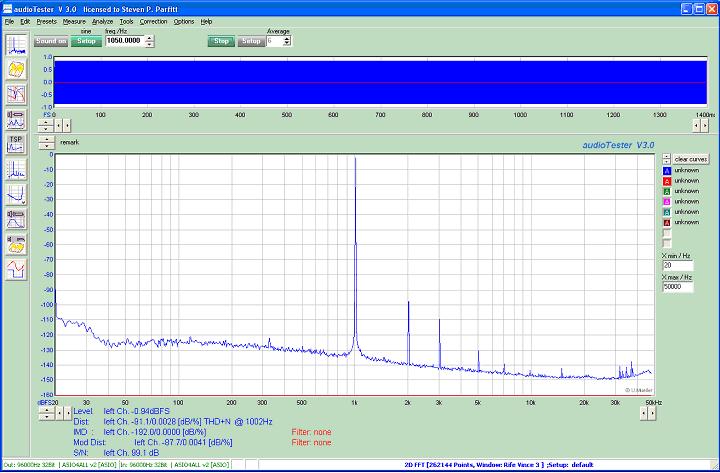

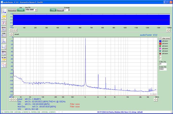

The title to this thread is because I found that for every current source I tried, and for every FET I tried, Source Follower induced distortion was inversely related to current.
At 3 mA and below, current source induced FET distortion dominated tube distortion!
At 2mA second harmonic is at about -74dB wrt 2.82Vrms 0dB ref.
At 20mA second harmonic is down below -100dB, a difference of over 25dB!

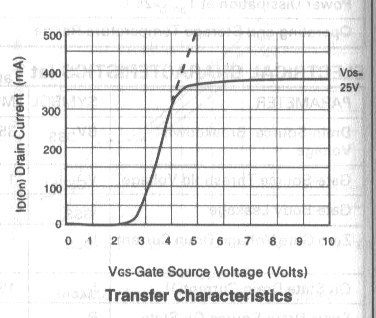

With MOS devices, the "Threshold Region" of low drain current is the worst-performing region.
Diodes (the new Zetex owner) don't publish the curves any more, so here is a grab from the old data book, illustrating the threshold region of the ZVN0545.
At low current the Id vs Vgs characteristic is highly curved, compared to higher-currents.
In effect, for a source-follower, this means that the gm is changing as the load current increases (eg due to capacitance charging).
The output drive impedance for the FET is 1/gm, so the distortion arising from the load is also changing as the current increases.
For a follower, the small-signal output voltage is related to gm and the load RL by:
Vout/Vin = RL/(RL + (1/gm))
so the nonlinear component of gm is sure to cause distortion.
gm for the ZVN0545A is about 100ms at 100mA - and a great deal lower at 3mA.
The bipolar transistor performs much better at low current, but the base current brings problems of its own.

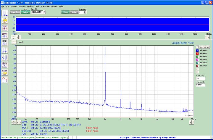

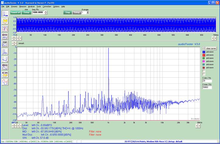

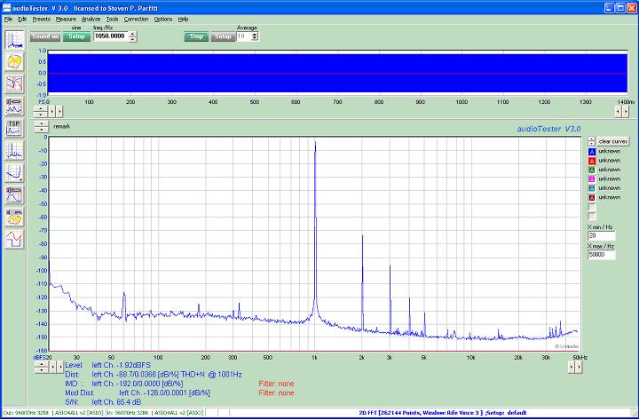

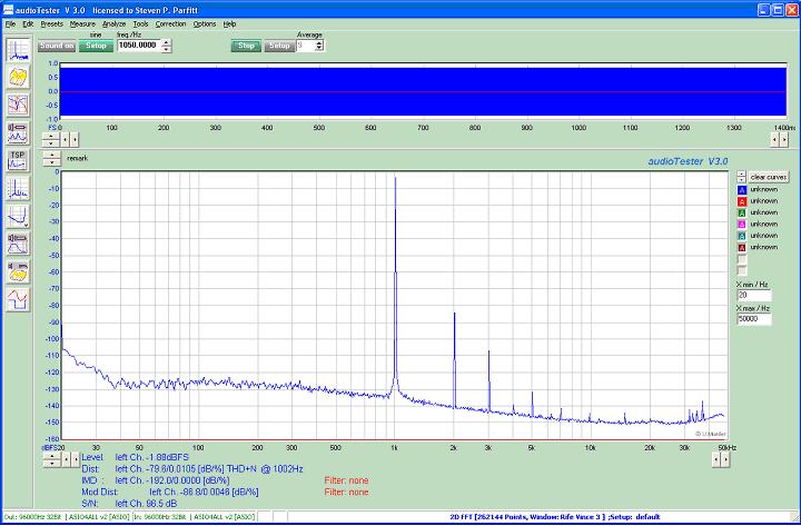

I built a buffer using a LF353. FFT 1 is the low distortion oscillator throught the buffer. FFT 2 is with the SF but no buffer, and FFT 3 is with the SF and buffer.
The buffer has reduced the 3rd and 4th harmonics, but second is worse.
I tried two different current sources and a gyrator and the results are the same.
I have also tried different tubes and get the same results.
I've tried the tube driving the buffer without the SF and the results are the same.
I'm at a loss for the high second order harmonic with the SF and buffer.
Out of curiosity, I tried a resistor which resulted in the same operating point and it looked really bad compared to the CS and Gyrator!
