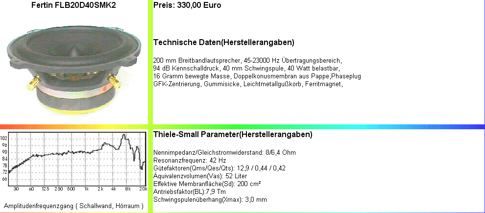

Ouch. That's one major jump up at 8Khz. The rest doesn't look too bad though I suppose -bit like the FE206E, or perhaps the ESigma in that it doesn't go quite as high. Good Xmax too. To be honest though, I'm becoming less and less convinced by the quality of 8" drivers like the 206/7 above, say, 15Khz. Luckily there isn't much musical information up there, it's more harmonics, but I'm starting to think rolling them off and bringing in a decent tweeter / super-tweeter around 10Khz is the way forward so they are running more wide than full-range. Call me a heretic if you will. The 6 1/2" drivers like the 166/7 are sweeter up top, and judging from its published response curve, and the couple of days I had a pair to play with in my enlarged BIB boxes, the 166ES-R is better still.

Salas, the picture that you have posted is the 20s not the 20EXC which has the electromagnetic motor. Also at 330 euros , it probably have the copper wiring , not silver. They sell for 323euros in Canada and the US. As for the wizzer cone, you have a choice of aluminum, brass and bronze. Today, I'll post some pictures and on-axes graph of the 20exc(copper and silver wirint) and of the 38EXC. I'm still waiting for the off-axes frequency graph.
