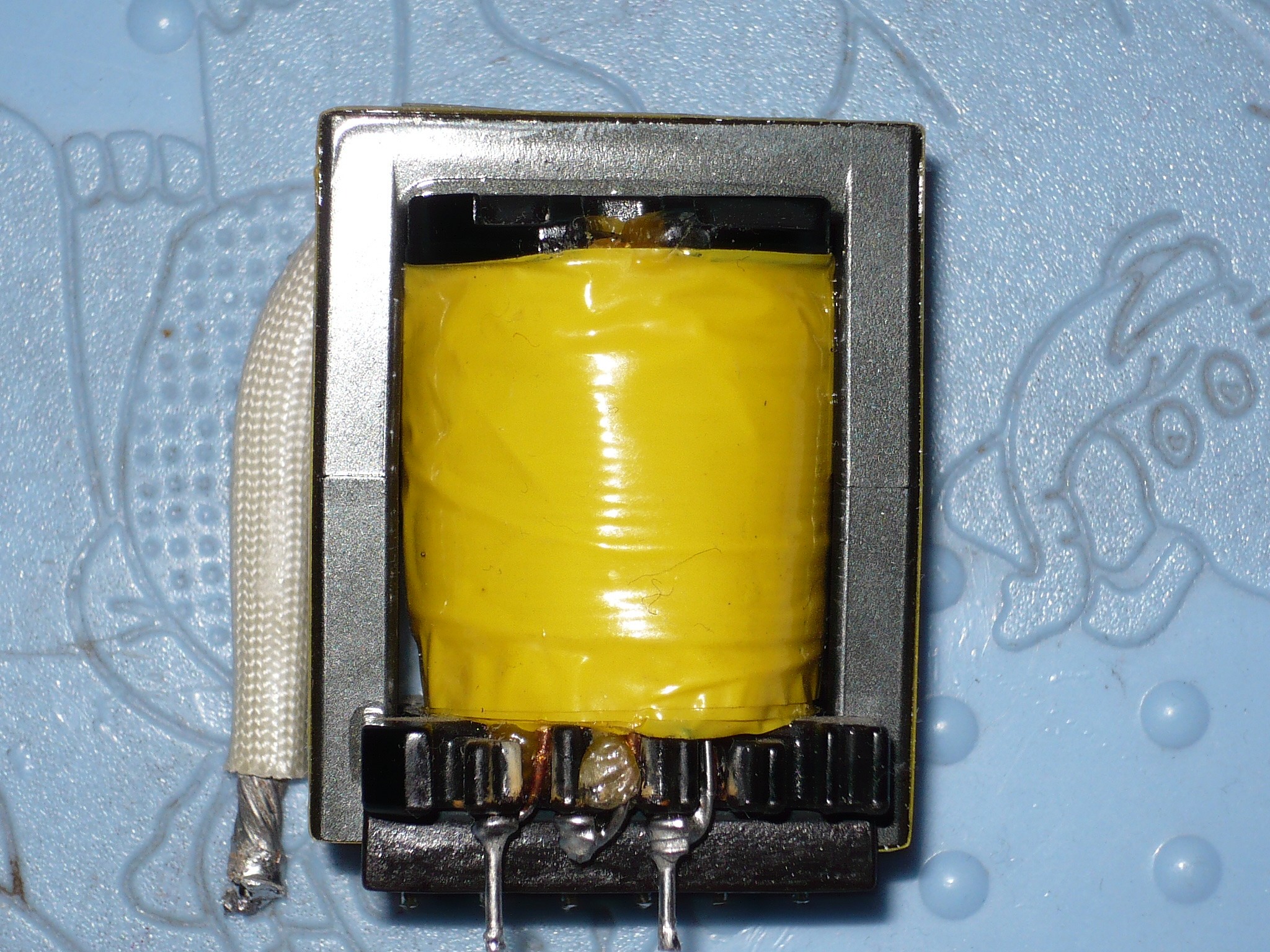

Hi all!
Seeking help from this transformer ATX power supply?!

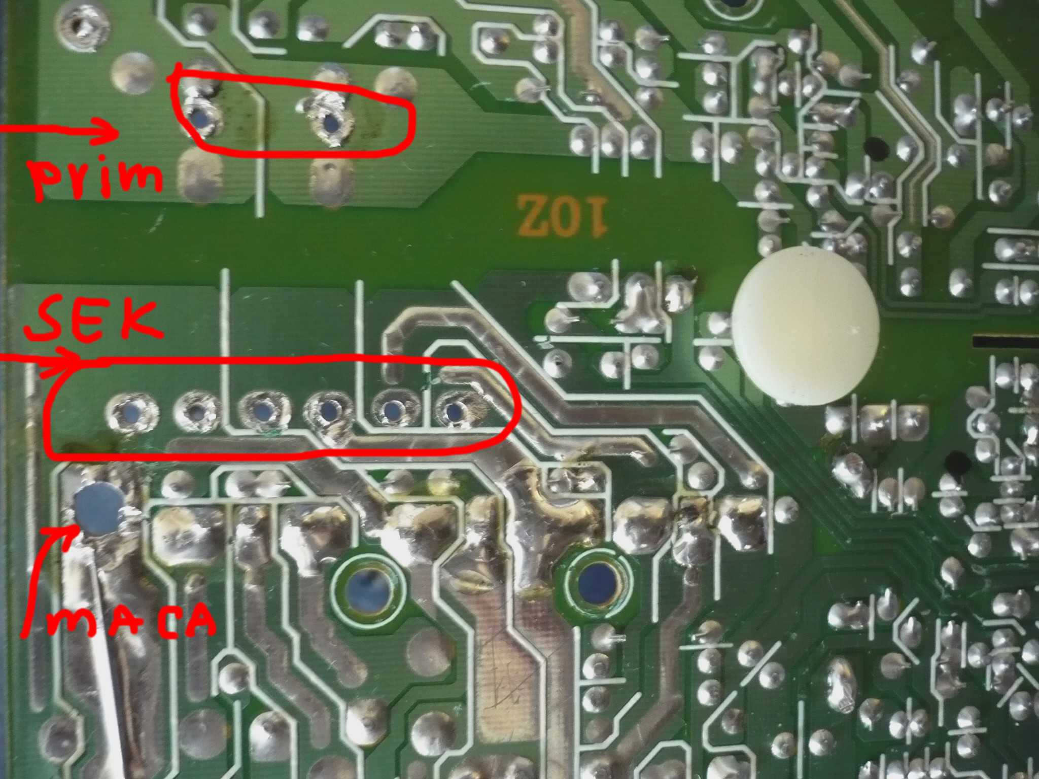

Here are some pictures of the ferrite Trafo (Figure 1-mark, Figure 2 - primary; Figure 3 - secondary; Figure 4 - PCB-back).
In one picture was given to his label, and the other two carried out the primary and secondary. A picture on the back of a picture of the PCB on the back side of the transformer was taken out then.
Question: Who performs the secondary transformer for 12V and for 5V that?
And where is possible to find data for this transformer this mark on the Internet?
I expect a quicker response, of course, if possible!
A big thank you in advance for your help!

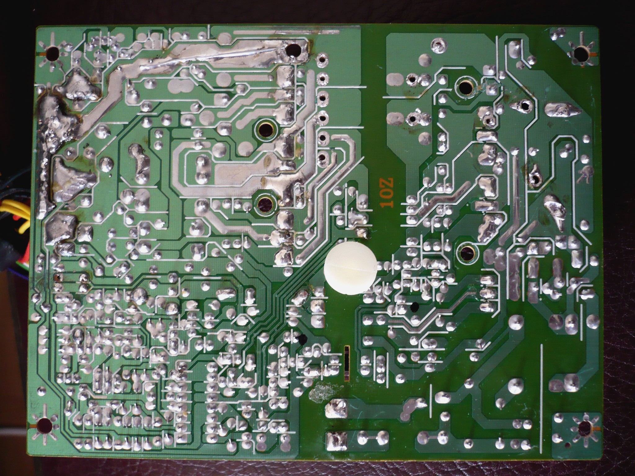

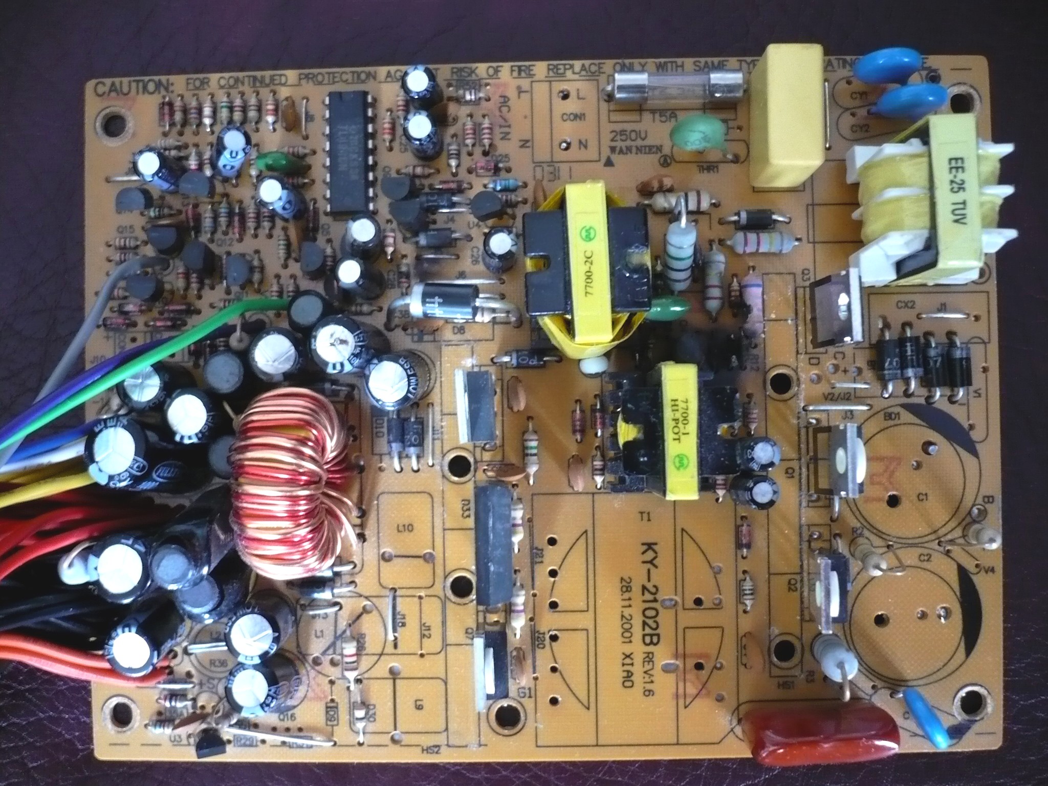

Show us a good picture of the back and front of the entire PCB without the red markings, but mark on the where the 5V and 12V output pins or wiring harness is. From that (if the pictures are good enough) we should be able to trace the circuit and identify 5V and 12V transformer leads.
Here are images of the front and back of the PCB ATX-power supply, where the transformer was taken out!
I think these pictures are marketed!

I doubt you can do this. 2 x 32VAC @ 6A is 384VA, the transformer is not capable of that, this power supply has a fake (fraudulent) 500W rating, it is really closer to a 200W PSU. Notice that even the bridge rectifier before the large capacitors you removed (4 diodes), handling AC line voltage seem to only be 2A rated (maybe 3A rated, it is hard to tell their exact size from the picture). Everywhere this PSU is built for less than half the rated wattage and the generic capacitors will probably fail - it just isn't a good candidate/host for spending a lot of time building a new SMPS.
The size transformer you'll probably need is too big to fit in the available space on the PCB. I also wonder if the switching transistors would fry at this load, but maybe not as using it for audio means a lower average current than 6A on the secondary.
Also you would probably need to remove and replace the other components on the PCB after the transformer, use a different controller or alter the feedback loop. While these things "might" be possible, I am wondering how you plan to do this since you hadn't yet been able to identify the 5V and 12V circuits as a preliminary step.
