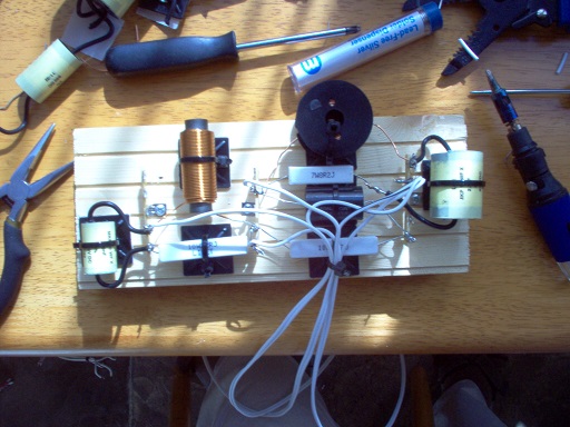

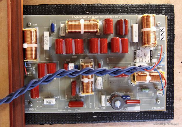

To be the audio heretic, Alan Shaw of lovely Harbeth, below, uses measurably non-linear ferrites (well, they COULD be soft steel actually...IDK) along with MKT capacitors often enough. Even in tweeter filters. And why not? Take capacitors. If they have some series resistance in the filter arm, why spend money on low capacitor ESR (aka Equivalent series resistance) MKP types?
I do think it's possible to identify which crossover components are worth spending money on. And it depends on the reactive demands or Q of the circuit, IMO. The below last bass 1mH bafflestep ferrite of mine is only being asked to drive an impedance corrected woofer. Should work well enough. And it does. 😎
