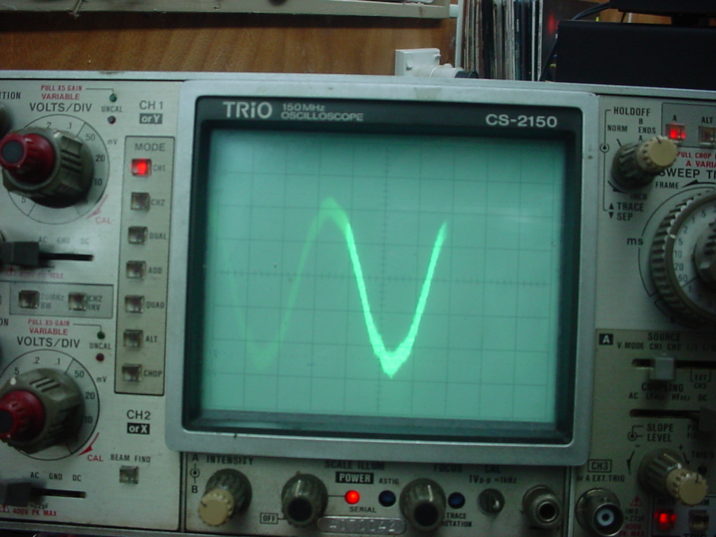

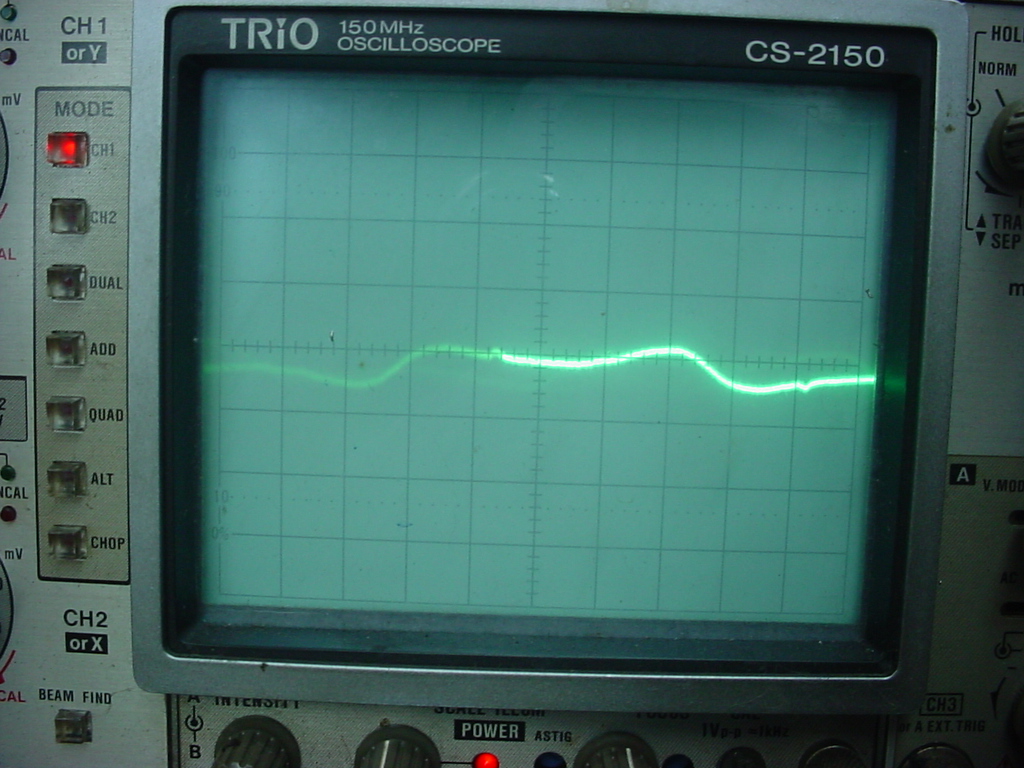

If you eliminate the hum by switching to the Dirty Channel, once you Re-select the Clean Channel, the noise is back. If you plug an earthed 1/4" Plug into the Effects Return socket, effectively isolating the Preamps, Noise is also gone, hope this describes it better. Attached are 'Scope Traces, taken at the Output Terminals of the RH channel Power Amplifier, LH is similar.
00986 Shows the Background Noise Before Plugging in a 1/4" Earthed Plug into either Input Socket;
00990 Shows the Hum Signal; this is quite Low Level, but very noticeable in the Amp's 12" Speakers.

And, Yes, I am aware that there is some oscillation in both Power Amps, Tried to eliminate this before by Replacing all Electrolytic Caps in Both Power Amps, checking all resistor values, Trial substitution of Output Devices. Have not tried substituting the Input Opamp yet.

The Question that You asked about the Control Effect: The Clean Channel Controls have No Effect at all on the Scope Signal.
