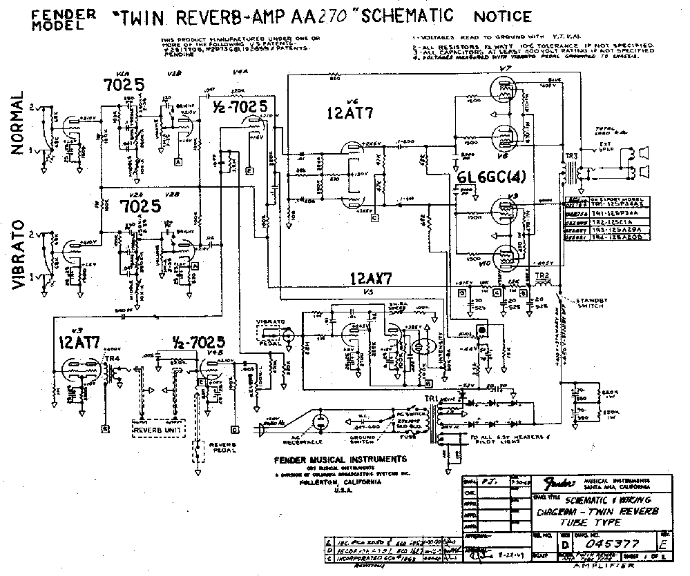

Yes the output transformer will read very low on an Ohm meter. Remember the output is only 4 Ohms.
The 70's Fender amps are usually pretty easy to troubleshoot. A Fender with no sound at all would have me checking power supply voltages first. Please remember that the Twin PS supplies over 400 volts to the output tubes and this can be lethal. The man I first learned electronics from (back in the tube days) told me to always keep one hand in my pocket when working on a "hot" tube circuit!
Here is a schematic for a Fender Twin of the era you describe.

Just thought of something else...
Fender amps have 2 speaker outputs. One has a "shorting" jack so that there is a load on the amp if it is turned on without the speakers connected. If the speakers are plugged into the wrong jack, there will be very little or no sound because of the shorting switch on the main speaker jack.

Your primarys might read 150-350 ohms plate to center tap, and yes its normal for your 8 ohm tap to read .3 ohms. The taps on the transformer dont read "impedance" with your dmm, rather DC resistance. Nominal plate load will be about 4k ( cant remember exactly for a twin reverb.) However if you measure them you get a very low DCR, causing you to assume you have a short.
I guess one way you COULD tell if your opt is fried is if you get a SMALL 6.3v transformer and wire it to the 8 ohm tap and see if you get a couple hundred volts out the primary. Oh yeah, make sure its unsoldered from the amp first 😉
