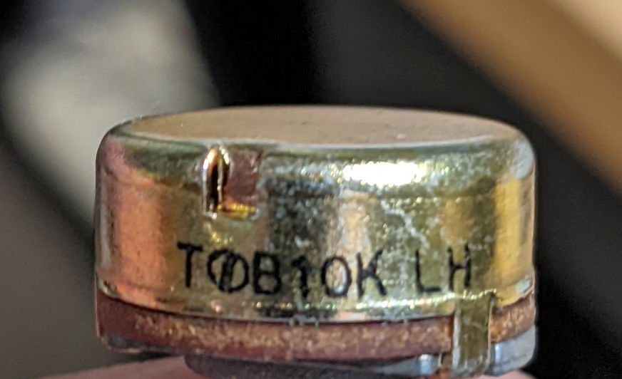

Yes, it's a feedback type gain control, so the pot taper is linear.
The tone pots are A taper, log type.
Yup.
https://eepower.com/resistor-guide/resistor-types/potentiometer-taper/
If you didn't know for sure, all you have to do is remove the old pot, set the pot at 50% of rotation,
and measure the resistance from the wiper to one end. If the measured value is about half the rating,
it's a linear pot.
it's a linear pot.

Thanks guys. I would have measured from wiper at mid-point to one of the legs, expect both pots are pretty mangled-- wipers ripped out of the bodies, legs broken. . . . Apparently, someone thought they really could crank them up to 11.
And that switcharound from A to B, B to A linear and log Tarzan mentioned always makes me wonder.
Linear it is.

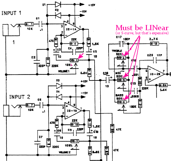

I saw the 3-band tone control. This type has equal + and - resistors (though here is 2.7k and three of about 8K) and will use LINear pots (or S-bend, but not in a popular-price product). These are noted "L", so the "L" in the input gain is also LINear.
Seeing this schematic I would have bet a dime that the input pots are LIN because that is one of the benefits of this t pe gain/loss stage: the curve is semi-LOG even with LIN pots.

Nevertheless, this is the same "10KL" input stage gain control. Now paired with the classic Fender tone-stack, best rendered with Audio taper, here marked "A".
Right, I had come across that schematic and it isn't the same. But PRR, if you say the input stage gain control is the same, I'll take your word for it. So we're still looking at Linear taper for those 10KL pots.

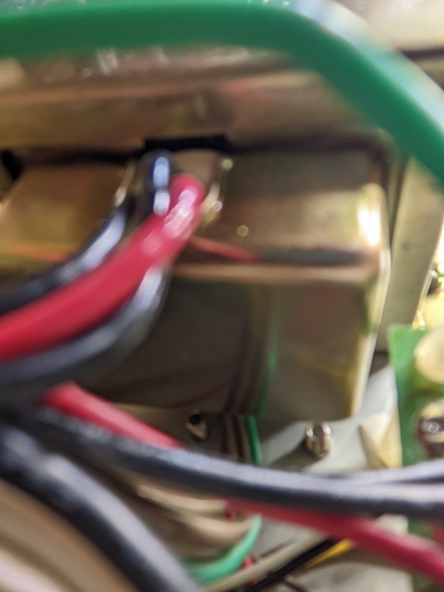

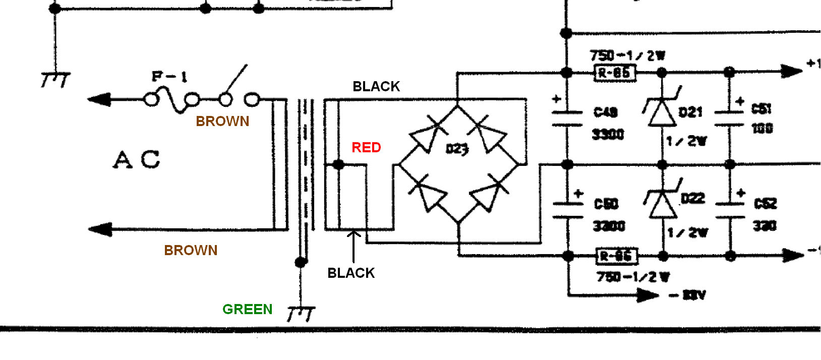

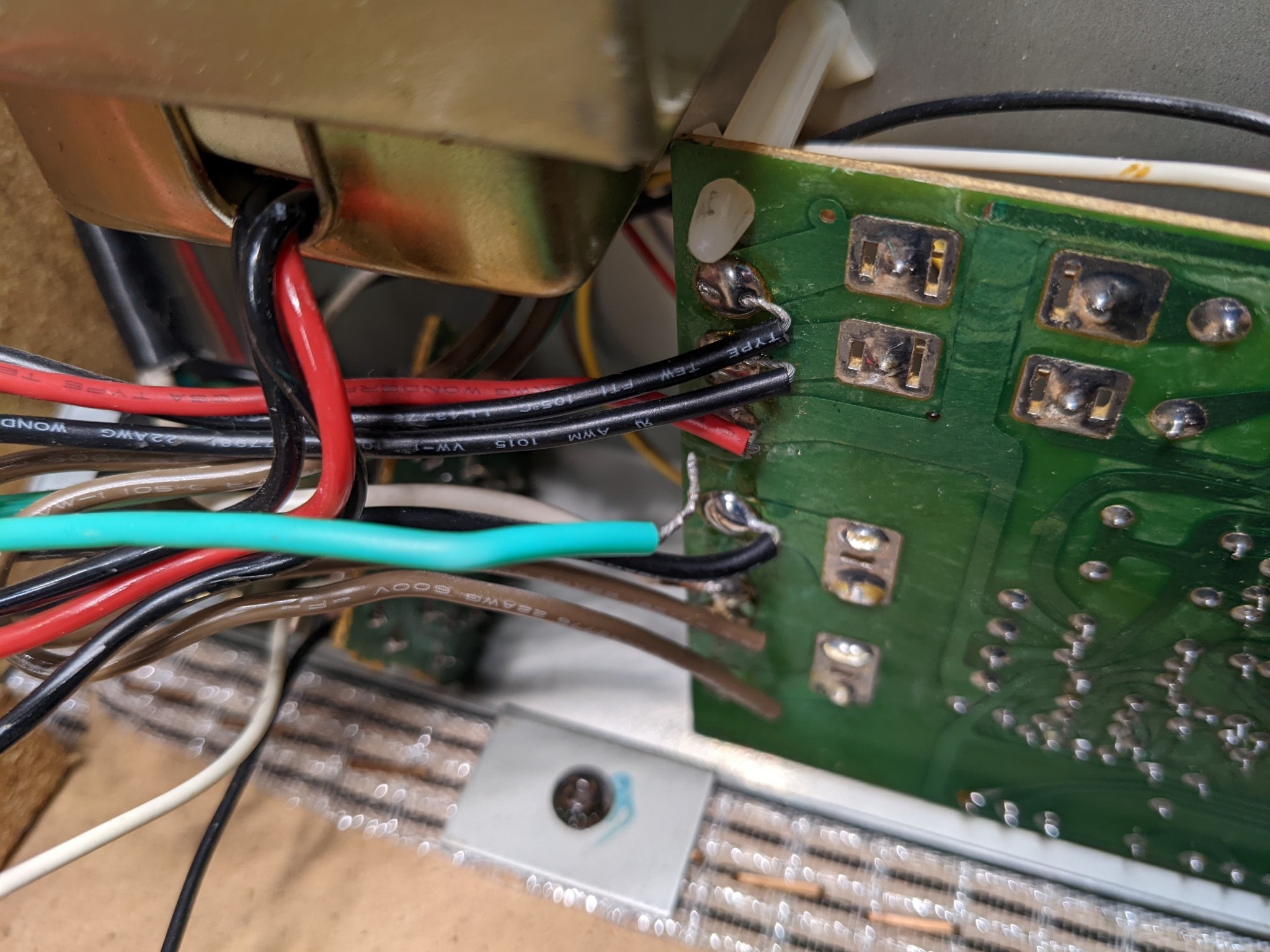

Schematic shows 5 "active" wires: 2 primary, 2 secondary and their center tap, 1 "screen"
Picture shows 2 Black ones (secondary?) and a Red one (center tap?)
It does NOT show (or does not identify) primaries nor screen.
*WITH AMP UNPLUGGED FROM MAINS AND PLUG ON THE TABLE, ALWAYS IN SIGHT
draw a "transformer map" showing all wires exiting from it and resistance/continuity between them, we want to i9dentify primaries, secondaries, center tap nd screen/shield.
OK, now you have a homework to do.
AGAIN: AMP UNPLUGGED FROM MAINS; turning it OFF is not enough.
Please, actual ohms in numbers, not basic "continuity" or "it beeps".
