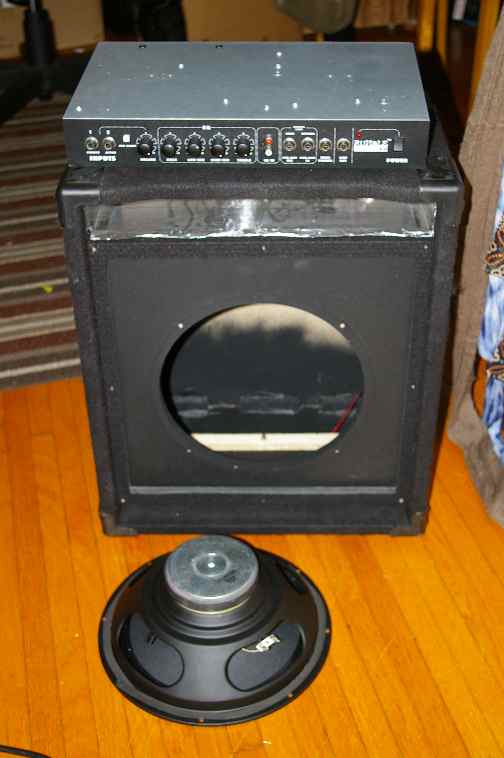

Well, I pulled the speaker in the cabinet,
and it looks underpowered. claim 100w but looks more like 50.
It could be distorting. There doesn't seem to be any rubbing,
but I'm not a speaker expert.
The cabinet could use reinforcing,
and it looks like I could reinforce corners/edges inside,
seal the box and port too, and drop in a higher-power smoother speaker.
What should I use for cabinet reinforcement, epoxy?
the speakers on my Twin dwarf the speaker here,
even though its a bass! Looks like Fender cut some corners here.
Has anyone got better bass sound by switching out speaker or cabinet?

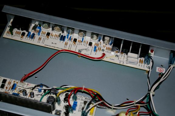

Looking at the chassis, the actual amp is a little integrated chip on a heatsink. Doesn't look like much!
I'm wondering if its worth it to just use the chassis to build a 'champ' or Deluxe 60 w tube amp on, and build a separate box for the head!

The basic speaker looks like this ($45 on Ebay used)
The magnet is quite a lot smaller and lighter than those on the Twin:
I'm thinking of swapping them!

The chassis for the Rumble 60 (at least this one) isn't made of Aluminium! It seems to be soft steel.
Its solid, rectangular and just about perfect for a small 2-tube push-pull power section.

Okay here's a closer look:
16.5 " wide x 9.75 " deep x 2.75 " (at back. 2.25" front) chassis
Recommendations:
Chuck integrated chip-amp,
and build tube amp on chassis, mount it in separate Marshall-style box.
12" underpowered "Fender Special" speaker, small magnet (prob.50w)

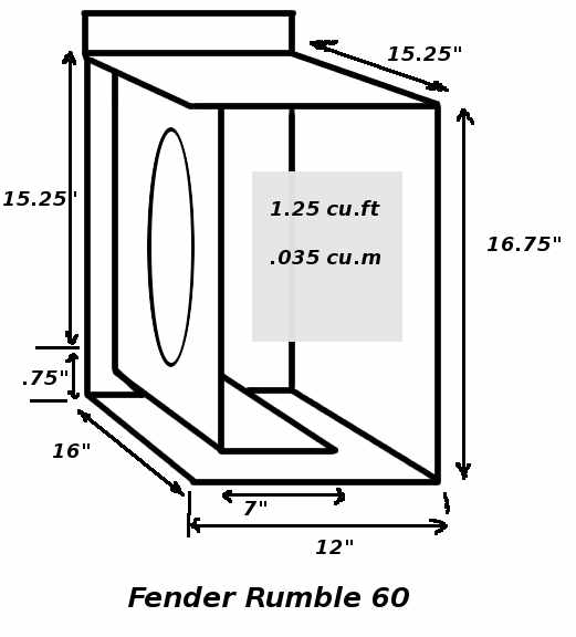

Bass Reflex Cabinet w. slot along bottom:
9" deep X 15 3/8" wide x 15 1/4" high (16 3/4" at back) interior box,
= 2140 cubic inches (1.24 ft³, .035 m³ )
with port/slot = 3/4" high x 16" wide, (12 Sq. In.)
and about 7" deep. (84 cubic in. in volume).
As it is, the cabinet has a horrible "honk/peak" with the low E string,
and another one about an octave higher. Very uneven bass response,
the four-knob EQ doesn't fix this,- not even in the ballpark.
Recommendations:
Put real 200 watt speaker in it,
seal port with plywood block,
add midrange speaker (in separate compartment) and crossover.
Reinforce cabinet walls with crossbraces,
and foam 3 sides inside to stop standing reflections.

After talking to my speaker expert guy,
I'm convinced that 90% of the (bad) sound from these units,
is coming from the cheaply made speaker enclosure.
I'm going to reinforce mine, and block at least part of the port.
If I can flatten out the honky peaks in the lower range (30-160 Hz),
Then it will sound far better at every volume above 3.
I may not even need to replace the speaker,
as stiffening and sealing the cabinet will allow it to handle more power without distorting excursions.
I agree the speakers are cheap in these things.Think I would write off the speaker to be honest, IIRC it's a low end Eminence in the Rumble 100, but it's far from the prettiest sounding speaker.
But I can't help feeling the cabinet is contributing
the greater part of the horribly unflat response.
I'd rather lose a little volume and get a flat fretboard,
because I might even eliminate the need for compression,
while preserving playing dynamics when I actually want them.
If I were you, I'd pull out your 15" and take a look in there.
I'll bet you'll see cheap.
And you can tap on each side of the enclosure with it empty:
I think you'll see that every side plays a different annoying note, like a cheap African drum.
I'm thinking of putting 1" x 1" strips across each side, on a diagonal,
and screwing/gluing them in place to deaden each side.
Then I'm going to put a layer of thick and weighty mattress stuffing on three opposing sides to stop reflections and standing waves.
I may also block up corners inside with triangular blocks.
I am betting the cabinet will sould 400% better with the same speaker.
I will keep you posted.
The speakers are definitely underpowered, but this is my first strike at the problem.
Maybe it will be better if not okay.
Then I will assess the need for replacing the speaker.

I replaced speaker and tested:
The two main resonances were still there, (49 Hz and 98 Hz), but a little less bad. Much of the cabinent distortion on other notes however were cleaned up, so this cabinet reinforcement is really worth doing.
I went back to my buddy at the speaker store, asked about a notch-filter. This was not good news, as the cap/inductor combo would require 150 mH (HUGE if aircore) and 20,000 - 40,000 uF caps. The cost was ridiculous, and the coil was made of unobtainium.
But the good news is speaker expert recommended stuffing the cabinet full of quilt-stuffing material to kill all standing waves.
So I gutted a 'comforter/pillow' and stuffed cabinet and replaced speaker:
FANTASTIC!
The two main resonances were about 80% killed off (still a slight and noticable peak/resonance but the bass guitar was actually playable and the notes near the 'resonance' weren't all blended together and indistinguishable.
Also, the whole bass fretboard was not only playable but sounded musically awesome (especially two-note stuff and octaves)!
Bass Guitar amp went from pure honky crap to sonic bliss.
Pull all your bass woofers, reinforce sides and stuff the box full!
You will be amazed.

Yes, I'd say thats VERY important!
I found that playing the Rumble 60 was awful,
as in not playable usefully past a very low volume.
This is because on at least two spots on the bass fretboard,
the notes for a 3 or 4 fret span were all blurred together and way too loud.
This was because of built-in resonances,
and made the little 12" speaker/cabinet useless.
I added heavy bracing, and stuffed the cabinet FULL of
blanket/comforter stuffing to stop the resonances,
and make the amp/speaker playable.
I also sealed up the reflex-slot and removed the light-show,
to make the cabinet have a more flat response over the whole fretboard.
This was the only thing that saved the amp/speaker combo.
Note that some volume was lost with those mods,
but this was necessary to restore musicality and balance.
Recommendations:
