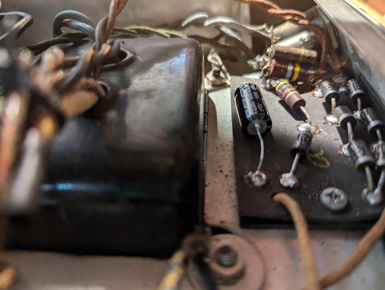

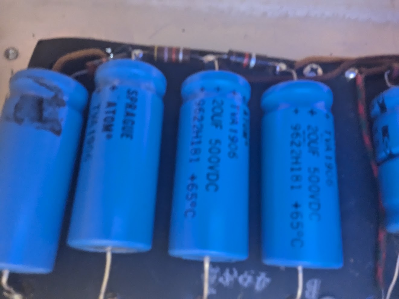

2.) the entire power supply was redone , Unknown power supply used with lots of extra wires, all electrolytics and some coupling caps replaced with Codes dating around '83 Mallory and Sprague atom. The reservoir caps look like 2 radials wired together in a way I have never seen before. 3 prong power cord was installed to replace 2 prong one with the green ground wire taped off. No ground. Ground switch still operational. Neg bias board rebuilt 100uf 75v cap, replaced diode, with two resistors added I have not seen before.

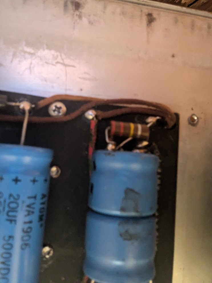

ok---what is the best way to test the filter caps ? looks like they were replaced sometime after 96 with sprague atom, I also have attached a pic of the bias eyelet board where it appears there arre two 100K resistoras stacked across the red transformer leads. ? I have never sween this on a Fender amp before and if it is I can not find it on the schematic. 2nd issue 2 reservoir caps are radial and I am unaware of how these are supoposed to work in this curcuit . If you have any advice as to leaving it or restoring it to what I think the schematic and layouts for these have. ?
