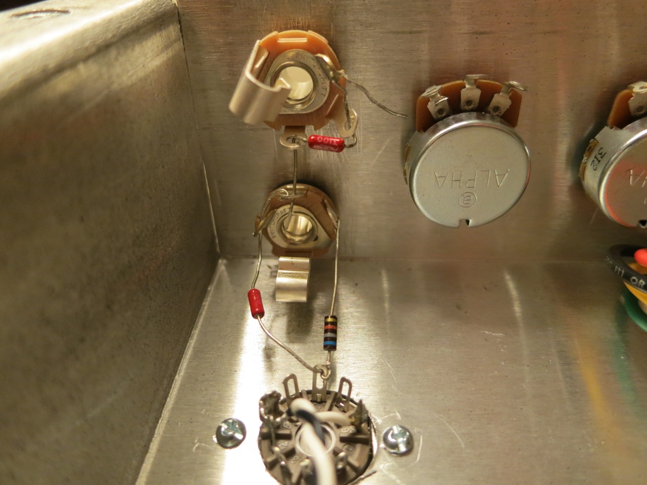

I am trying to wire two input jacks in typical Fender fashion with the Switchraft 12A's. I think my wiring shown is electrically correct, but worry that it might not be is nagging me.
I was hoping to get some fresh eyes to look at it and see if there is a mistake I am blind to.
The resistor on the bottom right is 68k CC, the bottom left 68k metal film (these going to pin 7), the upper 1M.
Thank you
Thank you

Bill that pot doesn't look wired up correctly.
