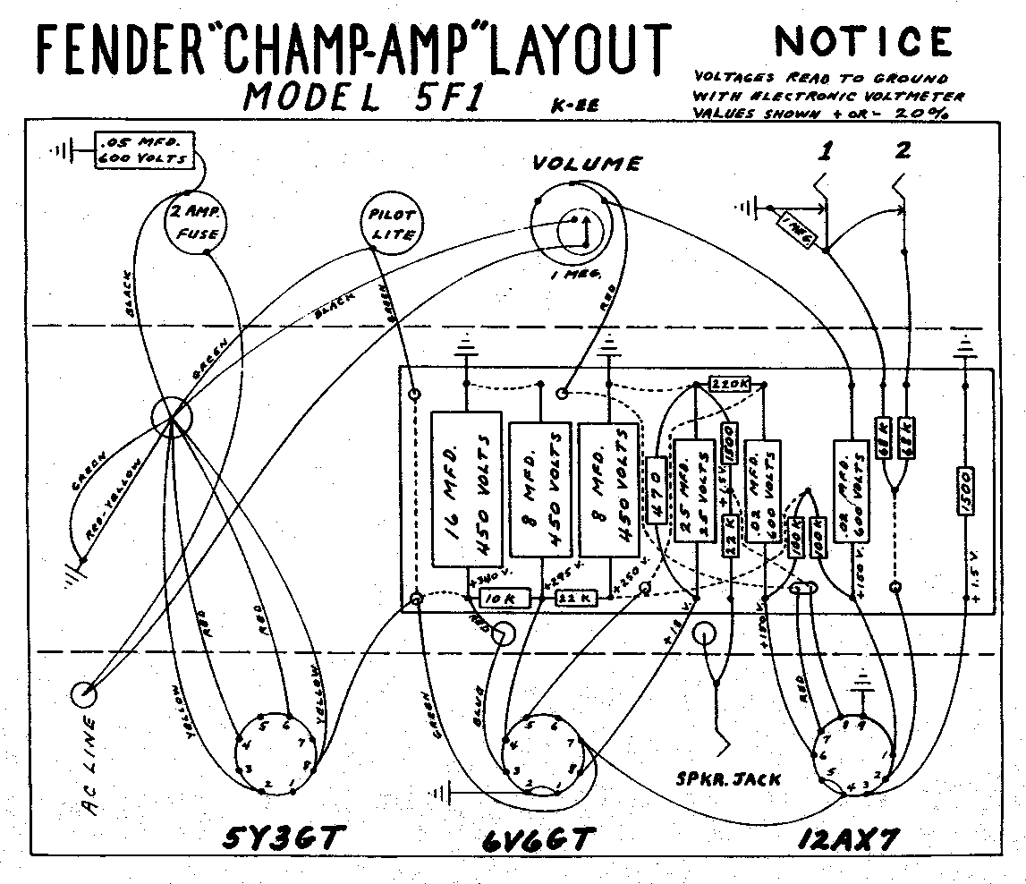

I've got a Fender Champ 5F1 guitar amp that has a crispy 22k ohm resistor on the speaker jack.
The amp now buzzes a lot, varies with the loudness pot. Funny thing is that it buzzes loudest from mid to high volume, decreases when the pot is turned to the loudest setting. That's usually too loud.
Does this sound like it could be a bad resistor? I'm going to go ahead and change the resistor, just wanted to get some ideas in case this isn't the problem. The crispy resistor is the only thing that visually looks bad. I tried different tubes.
Thanks!

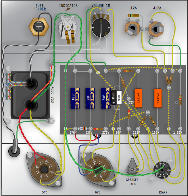

I failed to mention that the resistor is crispy because when I put the circuit board together, I omitted two wires between the two caps on the top left.
This amp was built from a kit and a schematic wasn't supplied, only the attached drawing. I downloaded a schematic later.

I built any number of Heathkits and Eico kits over the years. They always included a schematic, but the schematic was never a part of the building process. If they show a layout, then there will not be confusion over what goes where, ie not schematic interpretation needed.
This is the first time I assembled a kit without a schematic. It would have helped because I don't think I would have missed the two connections between the caps if I had compared the layout to the schematic.

Decided to build this guitar amp with my son and gave it to him as a Christmas gift, but I was not used to working from the drawing vs a schematic. You can download a schematic from the company website. I wasn't blaming anyone/anything for the fried resistor, that was 100% my fault since I should have loaded down the schematic before starting to assemble the kit.
The amp is still working fine, being used regularly by my son. It's a very good size and weight, perfect for gigs and he prefers it over the Vox amp he owns because it's not as heavy and bulky.
