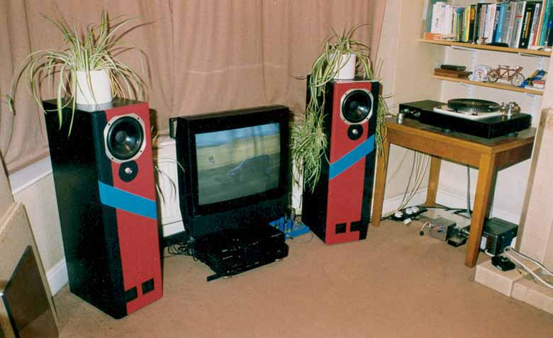

I've been rounding the edges of my baffles (1" radius) and covering them with felt since 1981. I also cover the front plate of the tweeter. The effect is to clean up the off-axis response and reduce lobing. Oh, and it looks pretty. There are other colours than black, you know.

EC8010 said:I've been rounding the edges of my baffles (1" radius) and covering them with felt since 1981. I also cover the front plate of the tweeter. The effect is to clean up the off-axis response and reduce lobing. Oh, and it looks pretty. There are other colours than black, you know.
Nice job... should be some inspiration to others to make all sorts of interesting looking boxes.
Did you use real wool-felt or is that the "plastic" craft felt?

I've no idea what sort of felt it was. I thought felt was felt, was felt. How do you tell whether it's felt made from hand-washed organic sheep or synthetic?
