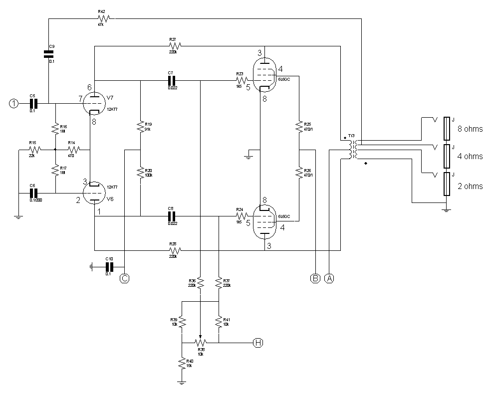

I am building this guitar amp for my son and I dont have data about phasig feedback across output transformer.
I made analysis myself and figure out the phasing as shown with dot convention on schemaric below.
Is it good or am I wrong.
