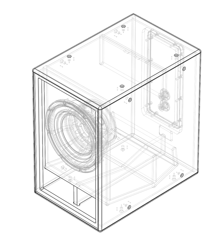

Can anyone figure out what's going on in the Danley CS-30? I can't figure out how they're getting a bandpass-ish response curve along with an impedance curve that almost looks like a sealed box.
Based on some comments from Ivan Beaver, it looks like the CS-30 complements the TH-Mini well, so I thought I'd pit them head-to-head.
(According to Beaver, the CS-30 digs deeper at the cost of low frequency efficiency, but the Mini has higher efficiency *and* higher power handling than the TH-Mini in the octave from 40 to 80hz.)

Here's the specs.
- Name : TH-Mini / CS-30
- Weight : 76lbs / 83lbs
- Driver : 12" / 12"
- Dimensions (in) : 24 x 15 x 22.5 / same
- External Volume (cubic feet) : 4.69 / same
- Internal Volume (cubic feet, estimated) : 3.5cf / same
- power handling (watts) : 700 continuous, 1400 program / 400 continuous, 800 program
- Sensitivity : 101dB / 95dB

What do u mean? There's a wireframe drawing of the internals. You know the external dimms, and can take a guess on a suitable driver for it. The port wall seems to taper, then flare back up towards the front of the cabinet.

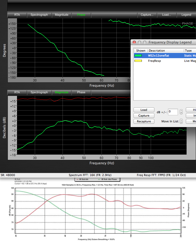

Looking at the cabinet design, it is obviously a single ported cabinet. The port design has been described in JBL white papers, it reduces turbulence at high port velocity.
As far as the impedance response, it does look odd for a cabinet that is ported.
As you can see in the comparison of a Lab 12 in an oversized (underdamped) box and the CS-30 below, the Lab 12 Fb is higher, but they both have very similar phase and magnitude response above Fb.
Art

I think I figured it out 🙂
Keep in mind, I was completely wrong about how the tapped horn worked when it first came out half a decade ago, so bear with me...
But here's what I think is going on in the CS-30:
- The CS-30 *is* something like a vented box, but with a twist
- In a 'typical' vented box, the port is tuned to a frequency that's equal to or below the FS of the driver. For instance, a QB3 box for the LAB12 is 4.1 cubic feet, with an FB and an F3 of 22hz.
- If you reduce the box size, the vented peak becomes both louder and higher in frequency. You get 'one note bass.'
- The unusual twist in the CS-30 is that the vent has a reverse taper. My hypothesis is that the reverse taper of the vent makes it a bit resistive, and perhaps reduces the level of the helmholtz peak

I took the images available online and 'reverse engineered' the box. This is what I came up with.
The image is a bit small, but the important dimensions are in the port. Here are the details:
- The end of the port terminates in a slot vent that's 7.62cm tall by 34.29cm wide.
- The vent narrows to a dimensions that's 3.8cm tall. That segment of the vent is 25.9cm long.
- The vent then begins to widen as we go towards the lower right corner of the sub. That segment of the vent is 17.27cm long. At the lower right corner of the sub box the vent height is 10.2cm.
- The final segment of the vent is 10.2cm long. The vent height at the final segment is 12.7cm. Note that the vent turns 90 degrees.

When box size is reduced, and Fb is kept the same, the vented peak reduces.
The Smaart comparison I posted was a single Lab 12 in this dual design:
FREE SUB PLAN: Dual Lab12 (Front Loaded) by Welter Systems
The "too big" box results in nearly the same LF port output, with a falling upper response, very similar to the DSL CS-30.
The single Lab 12 is 5 dB more "sensitive" than the dual in the 40-50 Hz range.
Art
The 90 degree "turn" makes the vent air velocity more symmetrical in both directions, the inside is more similar to the outside than if it ended before the turn.I took the images available online and 'reverse engineered' the box. This is what I came up with.

You will be surprised to find in the real world (not in your sim) that the 90 degree wide turn adds little to the port length.
Have fun with your sims!
Art

Patrick, take a look at the relative phase of the outputs of the CS-30 and TH-mini when used together. Trap for young players... hint: think about what happens to the phase of the output of a vented speaker below resonance.
