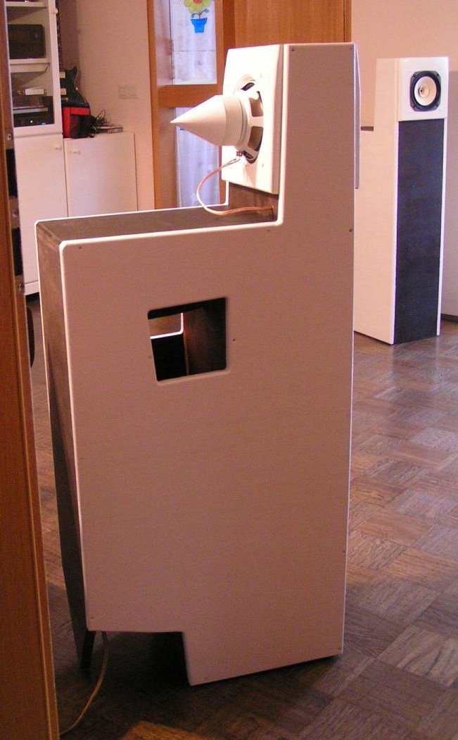

Hello everybody,
Im sure you already discussed some of it, but please I have a pair of the fostex fe167e at home and well first I thought to build the Chilli changs than I have got stuck with the cutting schedule esp. with the bracings. I thought to build the recommendet fostex basreflex but have god bad review on that so finaly im stuck.
Good review have so far I found: Chilli Chang, Metronome and the FT-1600 MkII
As I have alsolutely no experience and have never done such a thing im looking for advice. Please give me some recommendation. What would be the best allaround construction?

I am a novice and have just finished the woodwork for the FT1600mkII. It was quite a challange for someone who hasnt really done any woodwork (ever!) but they have come out looking ok. Veneering next.....
I've heard the Brines FT-1600 Mk-II (and own the LT-2000) and it's fantastic and very compact, easy to position and very space-friendly. The bass is lean and clean, plenty deep for acoustic music and not boomy to my ears.

I have bought the planes from Bob, and currently Im almost finished with the wood/mfd work...
A horn is too complicated, even a quite straight forward solution like Bobs FT-1600 MkII are than not so easy as it might look like.
About the sound I will be able to tell so in two weeks than I should be finished and have some hours of playing them.

I did. I am using screw in backplats so it will be easy to remove if necessary, just make sure you leave enough wire to go straight to the panel.
Hello Adamus might you please send me a photo of the filter? Im not realy sure how to make if I understand it right ... Unfortunately Bob has no photo.
its just the resistor in parallel with the inductor. This unit in series with the driver.
I havent got any pics, sorry.
but have found this

Hello,
would this be correct?
http://hex.dan.sweb.cz//IMAGE_00248.jpg
and then one lead to positive input and the second to the positive cable to the driver?
thats right.
+ve binding post to one end, then the other to the speaker +ve. speaker negative just goes straight to binding post.
