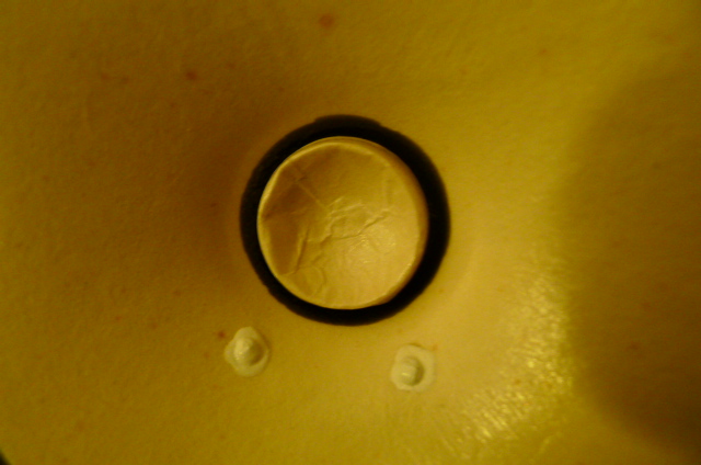

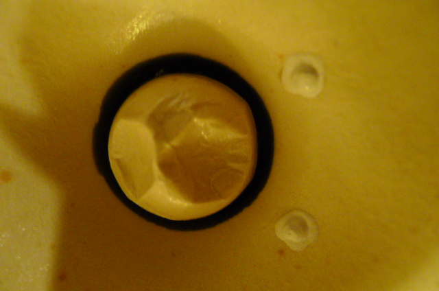

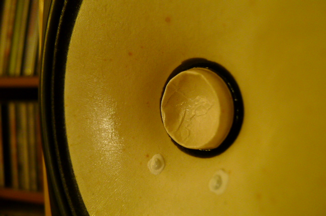

Couldn't figure out how to add an attachment on the forum e-mail, so here's a couple. Aidan wasn't content with an inquisitive poke, he went right for the jugular with a twist and pinch technique. Tried using tape but it didn't budge the dents much. A vacuum helped, took some of the depth out of the dents, but these are "after" pictures.
They might be pushed in too far for this technique (i'd try it, but you may need a dustcapectomy & phase plugs):

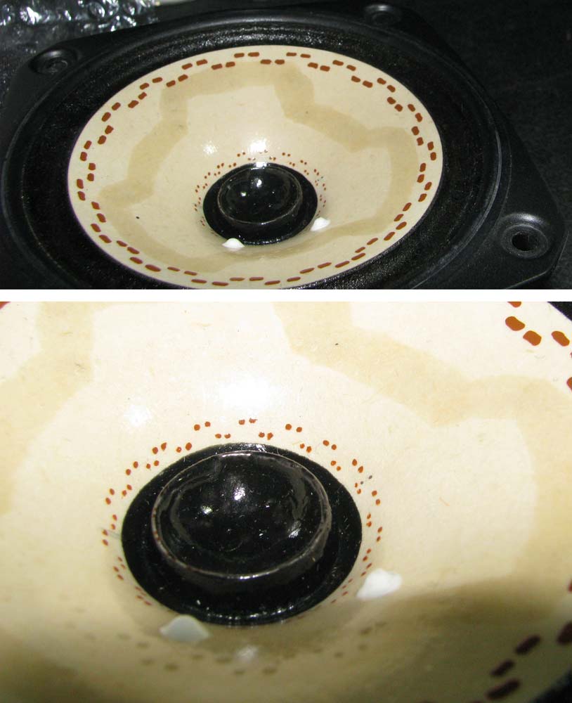

The idea is to carefully push the dustcaps in so that you have a concave dustcap. You will see in the closeup that the crease is at the top EnABL ring on the dustcap. Try to get it as symetrical and smooth as possible. You want to try to keep it about there -- too much doesn't work. You'll need to do both drivers. You probably want to take drivers out of the box to do it. After i did it i added a couple coats of PVA to fix it in place (diluted white wood glue will work -- i used mod podge i had dyed black.

I have had success with cutting a small V in what will eventually be the side of the restructured dome. This allows you to get in with some small blunt tools and enough force to pull the dust cap back out. You will probably need to find some crochet hooks to use as burnishing tools to take the last bit of creasing out. You can moisten the creases slightly too. Use a very fine , thin razor blade to make the cuts. An Xacto style pointed blade works the best for me.
It won't ever again be perfect.
After pulling it out you reseal the v back into the cap wit a small amount of carpenters white glue (poly vinyl acrylic).
The pin trick works if you have bent the end and can get enough force applied without tearing through the material. PVA for the hole.

Ok, I'll give it a whirl in the morning. Just push it down in the middle of the dustcap until it's mostly concave? From the pictures it looks like I'd stop when the still-convex portion of the dustcap is about where my dent ends, around 2mm from the black ring around it?
Any other tips/words of encouragement are welcome, I must admit I'm feeling a bit trepidatious.
approach slowly and cautiously. Concave than as little as possible. If they haven't been treated you can moisten them to help soften them and get the crinkles out (i've dented a few not being careful when i'm pretreated them)

Here's what it looks like after the first go round. I used my index finger and smoothed as much as I could as I slowly pushed the center of the dome down. The driver's had one light coat of puzzlekoat which I don't think made this any easier.
