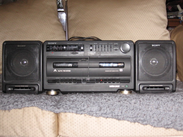

If you have the time, check some of the local thrift stores in your area for an old getto player like mine. The speakers are detachable, and the perfect size for an FE127. It should be easy to swap out the old full range drivers for the Fostex, and when your trip is over, take the 127's out and toss the plastic cabs.
FYI the Sony in the pic is a CFS-710 cassette only, $5 at a garage sale.
Have a great trip Ben.
Jeff
Jeff
