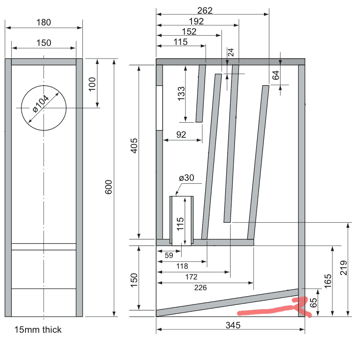

This is the Fostex recommended enclosure for the FE126E, and works surprsingly well - except for the clarity of the lowest octaves. With the bottom cut off as marked, you get a "cute" presentation that almost disappers (at least compared to any large BLH)

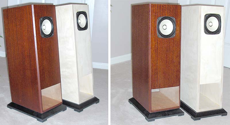

planet10 said:Here are a set of the monopole ML-TLs for the FE127 with the presentation from the Fostex design... the ML-TLs have very good bass, maybe give up a tiny bit in the mids to the FE126.

I'm not sure that Dave made it clear - the raw plywood boxes in the picture are the FE126 BR/horn, and the mahogany boxes are the monopole MLTL 127.
They arrived at within mm of each other without even comparing plans - I didn't even realize that until I put them side by side.
The bass is cleaner and more smoothly extended on the MLTL, but the efficiency and midrange prescence on the "horn" is remarkable.
Cutting the bottom of the 126 design results in approx 9dg tilt back - when my wife's initial reaction is "cute", I'll try to use that feature wherever I can. At about 8-10 feet listening distance, and a bit of toe-in, you're still within a the driver's HF dispersion pattern, and the imaging is quite nice indeed - they don't sound at all like they're sitting on the floor. Mated to a powered sub, either would make a great HT system (just keep the 126 away from the screen)
