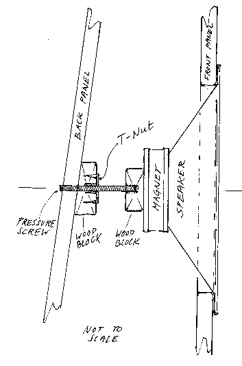

I was wondering how a brace of any sort could push and pull at the same time when attaching the speaker to the front. It's still sort of a mystery to me when looking at the holey brace designs.
Is the pressure screw technique described someplace? I can see
the t-nut but not exactly how the pressure is applied

The 'holey' brace or screw adjustable tensioner merely puts a bit of positive pressure against the driver/baffle interface to better couple it to the cab and keep it from moving around on its pliable gasket joint, i.e. improving its electro-mechanical efficiency.
The pressure is applied by turning the screw clockwise and once an audible point of diminishing returns is reached, anymore runs the risk of damaging the driver. In retrospect, considering your material choice, adding at least a front/rear dowel brace above/below the driver to maximize the tensioner's efficiency seems a good tweak.
The 'holey' brace requires either a predetermined pre-load (not a good plan IMO) or a small gap between it and the driver to allow shims since over time it will probably ideally need additional shims.
Some have argued/proven that this form of driver mass loading is self defeating in that the frequencies damped are actually distortion, euphonic though it may be, but speaker design is all about trade-offs and while many tube based systems have a bit too much for my 'tastes', 'dead' sounding speakers is a bit too much in the other extreme, so as always it's a personal preference sort of trade-off, like MDF or other low MOE material Vs BB ply or other high MOE one, i.e. any combo can be made to work well, just some work well without having to do extensive tweaking for the various types of speakers normally discussed/recommended here.
Folded horns require their own unique damping Vs rigidity trade-offs, so I don't recommend using them as a guide for designing other types of cab alignments. Anyway, my BIB MDF and/or PB panel substitutions were for back, bottom if flush against the floor/rear wall and whichever side was flush against a wall if corner loaded, i.e. no air gap due to baseboards/whatever.
