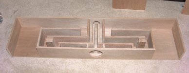

Progress report
Hi folks,
Thought I'd post an update to show progress on the speakers. Very pleased with the way they are coming together. Nice design scott, thanks.
One small problem with the plans - top/bottom are given as 300mm in length. The correct dimension should be 15mm less than that as the back is full height of speakers. Just in case anyone else is planning on building a pair.
jason

Size of round baffle
I'm wondering how you chose the size of the round baffle that the driver is bolted to? I've cut one at ~210mm diameter as this is the biggest my hole cutting tool goes to.
I'm guessing the purpose of this is to help imaging?

Jason - if you plan on painting the inside of the mouths, unless there's a special pattern involved, you'll probably find it a lot easier to finish the visible parts before assembly. Trace the panels locations with masking tape to provide an unfinished gluing surface.
FWIW, when we calculate the dimensions of supra-baffles (whether square, round or elliptical) we are trying to bridge the frequency range between the main cabinet baffle's step loss and the horn action lift. When I built the Aikos, I tried an ellipse, at 273 x 440mm - it sounded wonderful, and looked pretty cool too.
A large radius edge ( I used an 1 1/2" handrail profile router bit) helps reduce diffraction effects on round/curved baffle shapes, as does a 45 deg chamfer on rectangular or square baffles.

Cheers Chris.. so I guess my round supra-baffle is a tad on the small side.
I've got plenty of wood left over, so will have a bash at the weekend and see how my jig saw skills hold up. I was using a hole cutter to keep things symmetrical 🙂
I'd been considering painting before sticking the boxes together, think I'm probably going to risk painting afterwards. I think there is enough room. I'll probably live to regret that decision though!
I'm hoping to get to listen to the (unpainted) boxes by this weekend. Looking forward to it.

I don't think there's enough hard science on the subject of "supra-baffles to categorically pontificate that any one dimension, parametric formula or cross sectional profile is "the best way".
So, in other words, by all means use the baffle you've already cut, but if you can make allowances on your install for experimentation with others.
Most importantly, when you sit down to listen on the weekend, relax and - trust your emotional reaction.
