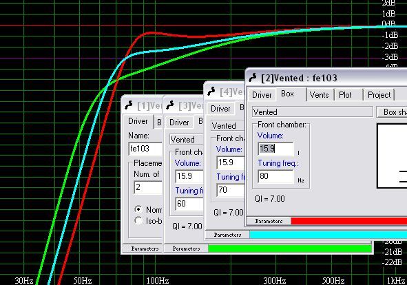

I suggest you put 2 drivers in each cabinet with one rolled
off to give you baffle step compensation, obviously roll-off
the driver with the poorest treble.
I presume you'd run an alnico Fe103 full range with a RS1137 rolled off.
The port tuning is in the range 60 to 80Hz.
For a 40mm dia port :
80Hz - 70mm
70Hz - 180mm
60Hz - 350mm
Tuning of one driver in the cabinets is very poor.

That's an interesting possibility. Are the graphs you attached for two drivers in the cabinet? I'm a novice at speaker building . . . how is rolloff accomplished? What type of part/circuit and what value(s)? This sounds somewhat like a pair of vintage KLH speakers I picked up at a thrift for a couple of bucks. They have two of the ubiquitous KLH 3" drivers in each cab and are ported but they're very thin (13.25" x 17.5" x 2.75") and were made to be hung on a wall. They supposedly have some kind of "compenstation" network or something - not a simple crossover. They're called the Model 14.
Yes the graphs are for two drivers per cabinet.
One driver has a series inductor - usually in the range 2mH to 5mH.
Suggest you wind the inductor yourself and set by ear.
