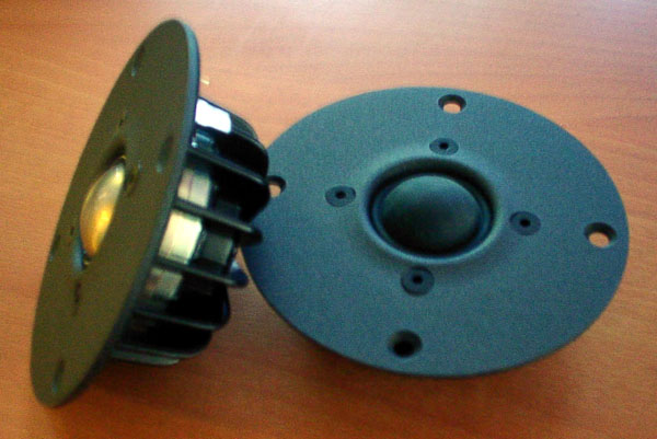

well-ehhh.......XXX 3" mid.
the designer's goal was to develop a middome that could handle the difficult job between 300-4000hz and i think he got it right...

tbla said:well-ehhh.......XXX 3" mid.
the designer's goal was to develop a middome that could handle the difficult job between 300-4000hz and i think he got it right...![]()
Better then the ATC??? Or did you mean ATC?
amo
....i meant the atc, but i felt a bit embarrest to mention it again - i have mentioned it alot......
many people knows it and its reputation but i think only few have actually listened to it.....🙂
