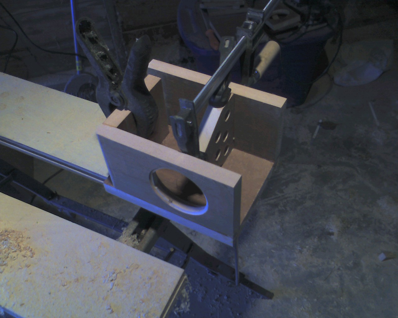

I clamped a board on the side of the radial arm saw so that it was easy to get all the side, front, and back pieces the same height.
This was the first time I had ever tried to cut a circle with my router.
I made a jig that the motorboard rotated around that allowed me to get some nice neat circles cut out.
Some of the pieces sitting around.
Part of the first one getting glued and clamped.

How are you going to work the holey brace so that you can swap to the proper drivers in the future.
Installing the HK, into a box for the FF85 is a bit of a crap=shhot, hopefully they turn out tolerable 🙂
dave
It will allow a wider champher at the edge...
I'll size it so that it works with the HK driver.
Than when it comes time for the FF85 if the brace is too large I'll carve it back a bit with a 1/2" router bit, if it's not large enough I'll build it up with another strip of pine glued on.

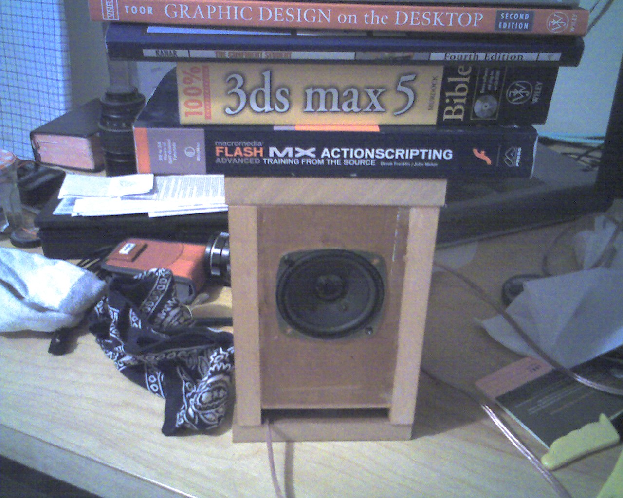

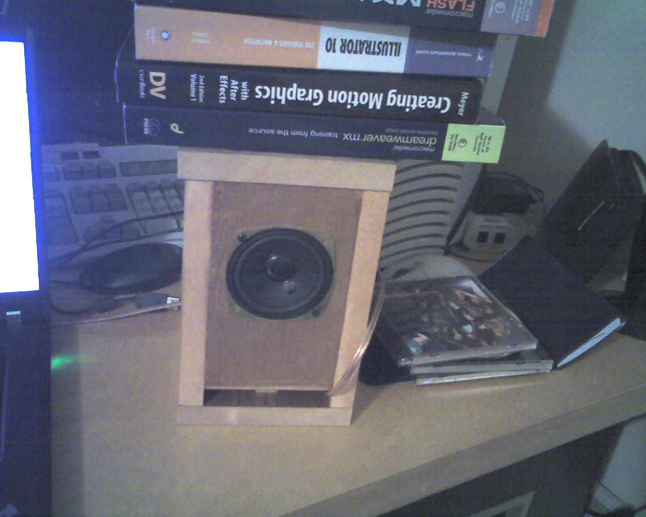

More Pics
Update with some more crummy pictures.

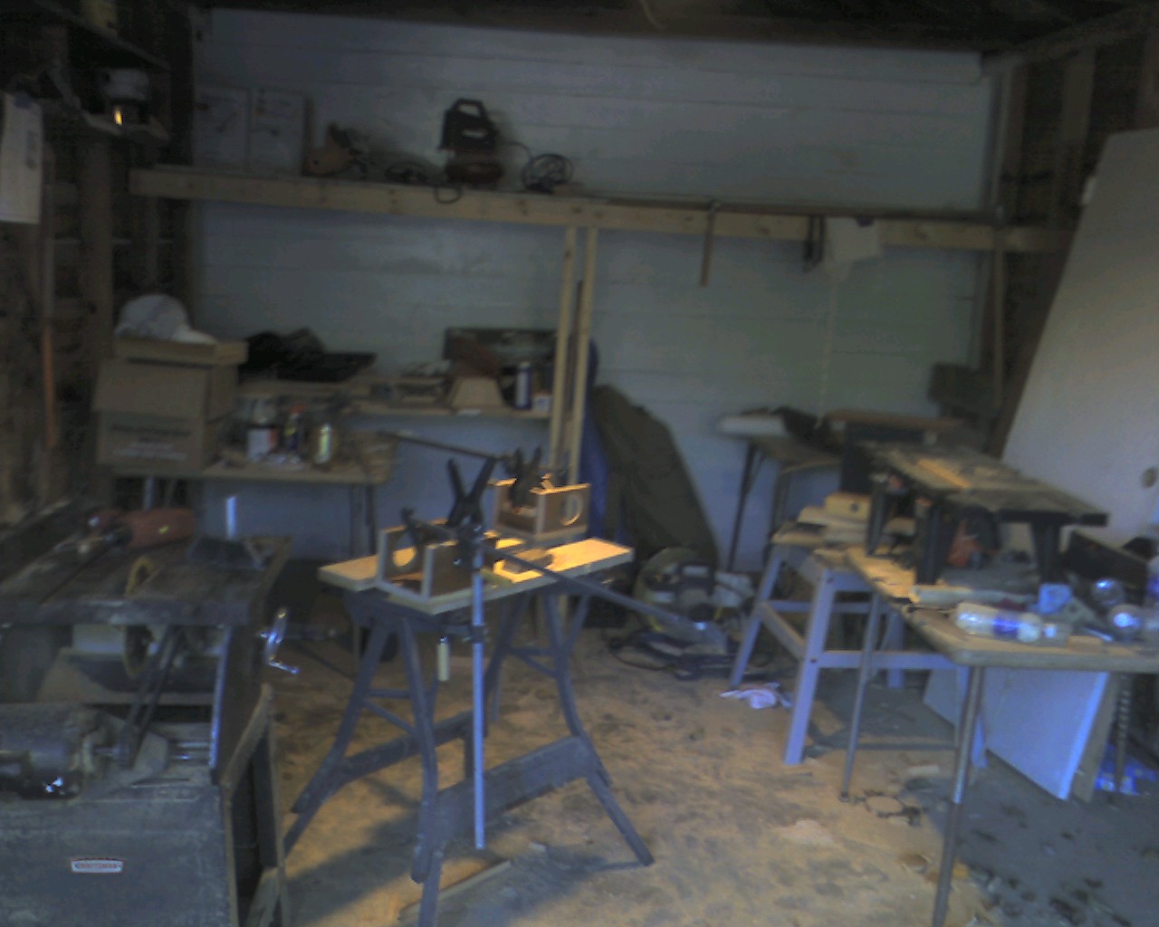

More clamping and glueing,
The work shop,
a big step up over my previous setup which was a borrowed table saw in my driveway.
So far my most expensive tool is the Bosch Jigsaw for which I paid $89 USD.
I love craigslist.

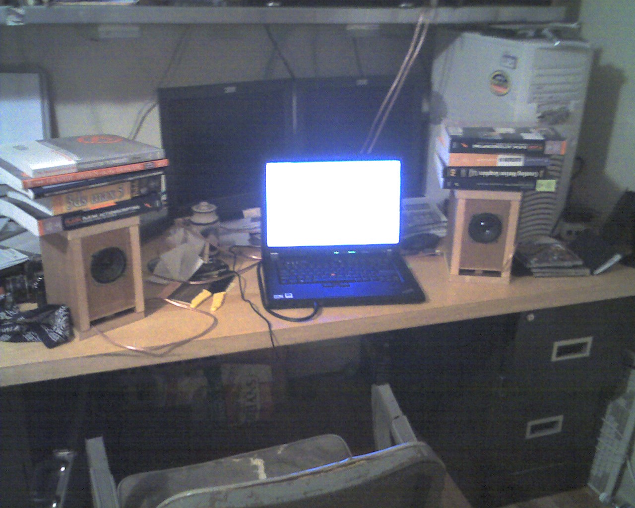

A preliminary test without the top and bottom glued on.
And my new Lenovo T500 🙂
Left,
Right,

They sounded pretty good.
Fairly weak in the lower frequencies.
Not really expecting much there.
They imaged much better than expected, probably in part to having them hooked up to a "real" amplifier.
I can't imaging the stock unit built in as being that great.
