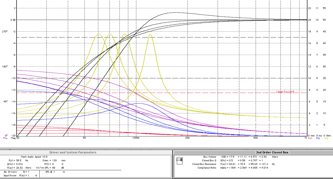

See the attached sealed sim to get an idea of how big to make the A10.3 box. For WAW i usually go further and do a midTL for the midTweeter.

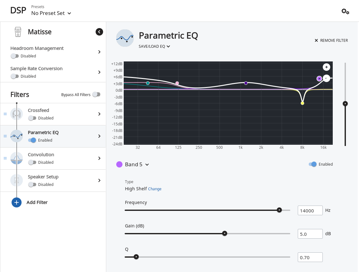

Roon cannot be used to make separate LP and HP for different channels, just global EQ. I has very good sound and I have noticed its EQ´s sound quality is night and day difference compared to my old PA 32-band graphic EQ which always steals resolution and sound weird. When using Roon I am unsure if it makes somekind of phase problems etc. in XO frecuency (when using passive XO) if using shelving filters with it when trying to level volume of 15" 2226H woofer.

So as near as possible. I can use kerfed MDF inside box and make custom chamber for Alpair. Regarding sealed volumes in your chart, 6,5L would be enough if using 300hz XO point?

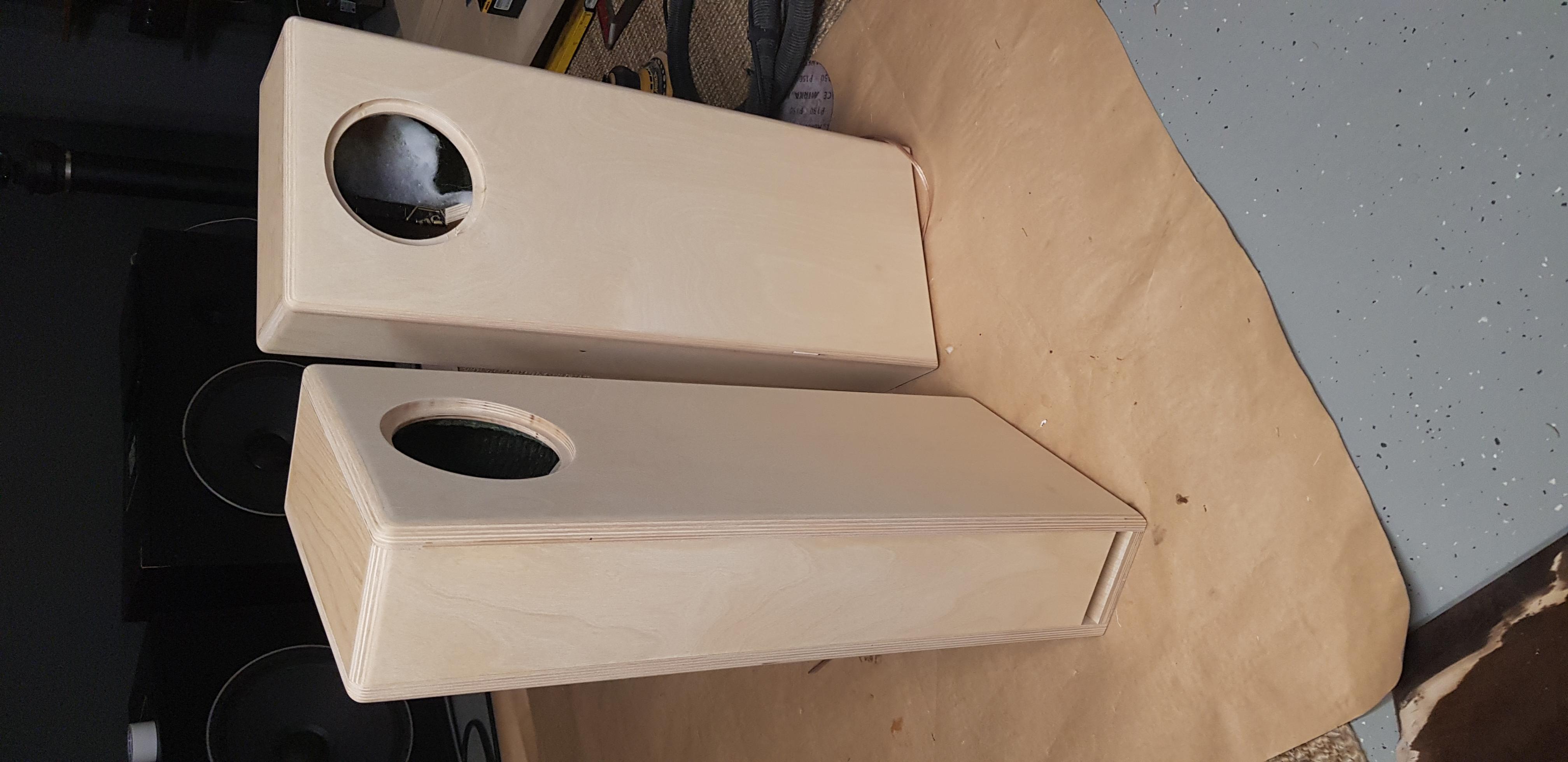

I drew it, but have not heard it, can you tell us more?
dave
That is great to hear! These were my first fullrange build. Needed shallow enclosure for my small sauna cottage and when searching options decision was clear when founded them: shallow, can be placed to near wall.
I made them from birch plywood. They sound great and bass is surprising, everybody who has heard them has been amazed how two small drivers can make such bass. Bass is accurate and not bloated, kind of "HD" bass compared to my earlier speakers.

Roon … just global EQ
I wa sthinking about that today… is it parametric? Can you create a shelf? Maye with a dip in-between.
I tend to like a bit bigger but 5 litre stuffed shoud be good. If sealed XRK’s "dagger shape" is good.
I was thinking about that today… is it parametric? Can you create a shelf? Maye with a dip in-between.
Yes its possible, see attachment pic. I think this could be first option to try besides PLXXO which are strange/new for me.
So Roon EQ for level matching and passive XO doing slopes at 305Hz..
