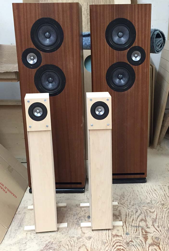

How much of a "behemoth" of a FAST system were you contemplating? I recently finally refinished a pair of bi-amped MTMs using Alpair drivers that work quite well. They are approx 48" tall x 18" wide x 10.5" deep.
Shown below with a pair of FH -lites for size comparison.
The format would easily be adaptable to a fair range of drivers of your favorite flavor; indeed this was my second pair of similar design - the earlier build used FF85K, the current successor to which would be on my short list for consideration for such a project.

Andrew, the system components were Alpair 7.3 as mid-tweeter, and 2 x Alpair12PW (woofer version) in a shoehorn tight fit MTM.
I'm not sure if Dave has released the drawing publically, but it's probably no surprise to those familiar with his work that it consists of a small triangular, rear vented TL for the A7, which is surrounded by a slot ported MLTL for the dual woofers. He might care to elaborate more precisely on the details of the enclosure.
They are currently running actively bi-amped, via an Onkyo 7.1 receiver, and supplemented as much as they need it, with a pair of corner mounted dual 7" woofer "subs". Even by themselves in "direct, stereo" mode, a quad of 12PW in a 340ft^2 basement room deliver enough slam for me - but then, I'm an old fart, and don't listen particularly loud, even to movies.
