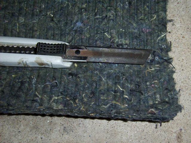

Well something better would be that thick underlay/sound proofing that most cars have under the carpets, made from shredded cloth type material, I'll take a pic...
ok but i only have this foam stuff, the only other thinf i have is a bit of old wetsuit material but not enough for a 100L enclosure.
