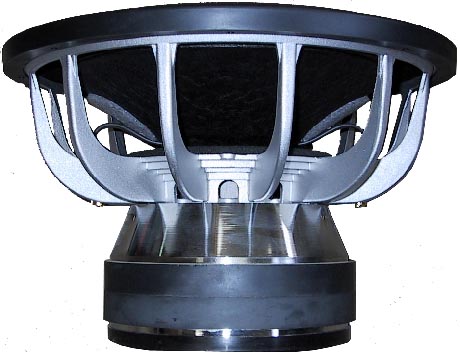

I'll check the PD driver. Could you please give me the link?
But how about
Adire Audio Tumult?
http://www.adireaudio.com/diy/Drivers/Adire/tumult.htm
More than three times the displacement of 18" Fane
with an 15 inch driver.

Sounds quite like my current Fane to me. It has quite
the same charasteristics than the PD driver except that it is
18 inch.
But have you looked at Tumult? It has 68 mm Xmax peak
to peak (that is linear excursion).
http://www.adireaudio.com/diy_audio/drivers/adire/tumult.htm
Actually their claim "Tumult is simply the most displacement you can buy, period. " seems to be true since it exceeds even
the 24 inch driver because of its long excursion.

How about using four of these?
127 dB at 20 Hz without exceeding the linear excursion
and maximum power limitation. That requires 6400 W
of amplification, but 127 dB at 20 Hz is quite loud, isn't it.

And if you look at Adire Audio Tumult's specs, one 15 inch
Tumult is propably more than one 24 inch PD and it is
3.5 times more (in terms of displacement) than one
18 inch PD/Fane. I am expecting that I could do a
subwoofer from Tumult that could be directly comparable
to Velodyne's HGS series in terms of low distortion.
