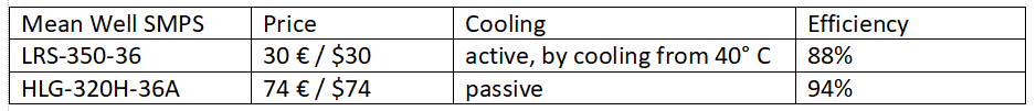

I'm currently thinking about whether I should use an LRS-350-36 or HLG-320H-36A. Of course, the LRS-350-36 is cheaper, but the main differences are the cooling system and the efficiency. The prices for Germany include 19% VAT. The prices in $ are without VAT.
I am particularly interested in the LRS-350-36. According to the technical data, the fan of the LRS only starts to run at a temperature of 40 degrees Celsius.

I used the LRS-350-48 with the TI 3255EVM board for several months and never had the fan turn on, so I'd call that experience quite good. This was with 104db speakers in a small room.
On the other hand, I tried using two of the 24v versions in a Pass class A amp, and the noise was incredible, with the fans running full time.
Depending on your actual current requirements, you might be able to use the LRS-200, which has no fan, but does have a nice mesh-type open case, along with, if necessary, a small silent computer fan and you'd have silence. Good luck with your build.
I just bought a pair of Meanwell UHP-500-48 to power two TPA3255 amps. It's fanless. Costs a little more, but you get peace of mind that there will be absolutely no fan noise. Give the UHP line a look.
